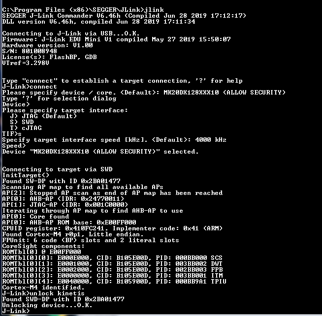

I have a Jlink on Widnows, with JFlash.
How do I unlock and mass erase this chip? I don't see project files for it anywhere in JFlash.
Additionally, is there any way to interact with the chip using OpenOCd on Linux? I can flash the chip using the following instructions to patch OpenOCD, but none of the Kinetis commands work. Any idea why?

Evidently, this is how:
My question still goes for Linux, though. How can I use the Jlink with OpenOCD to work with this K20?

kerryzhou
Hi Chris Seto,
   So your question is mainly in linux, not the windows, is it right? From your picture, you already can unlock the kinetis chip.
   If yes, you can check it with segger JLINK, how to operate it in the linux, they will give you the detail information.
