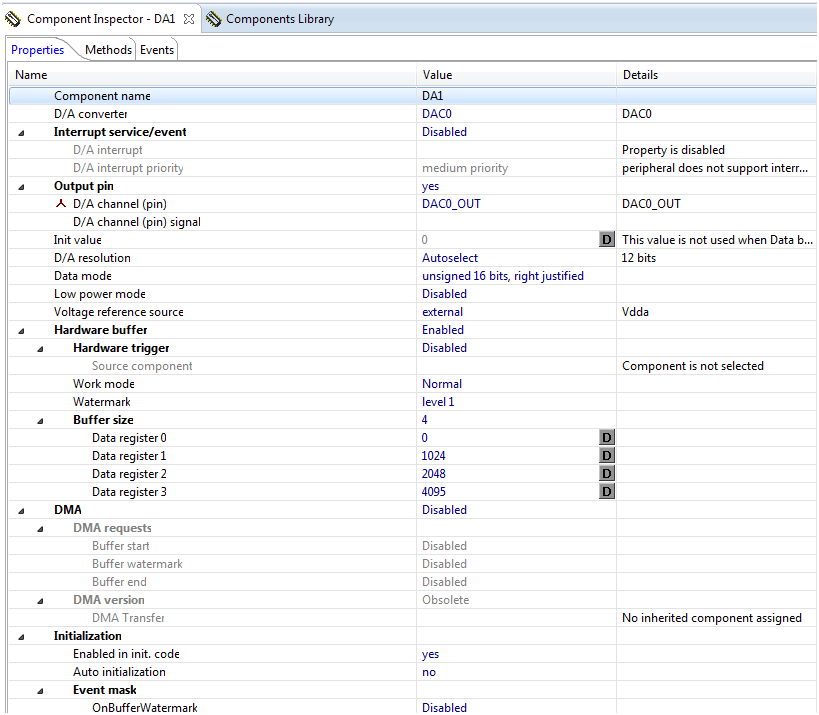

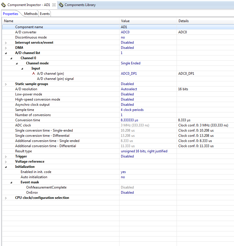

Basically for the past month I've been learning embedded programming while working with TWR-K40X256 (MK40DX256ZVMD10 micro-controller). Right now I'm tasked with converting a generic sinusoidal wave (like a sum of sines) via ADC, applying some basic digital signal processing to the data and then converting the processed digital data back to analog using DAC (kinda similar to yours if i understood correctly).
I've decided to use Processor Expert for this and so I've added the components DAC_LDD and ADC_LDD to the project (images of the configurations below).
Looking through the Typical Usage for both the components I've tried to implement a continuous measurement of a selected sample group (w/ interrupt service) without much success (measured values are always 0) and for the DAC part i am generally not sure about the way to implement the conversion.
Do you have some suggestions or code snippets on how to solve the problem/implement the system I explained?

I can't help with the PE setup but if you want a working solution you can simply use the uTaskerV1.4 project which includes a buffered ADC/DAC configuration based on DMA and PDB which is very practical for adding signal processing in between.
The ADC/DAC configuration and operatrion is explained in the document http://www.utasker.com/docs/uTasker/uTaskerADC.pdf
Download the uTasker project from http://www.utasker.com/forum/index.php?topic=1721.0 - it will build with CW, KDS, IAR, Keil, Rowley, Atollic, Coo Cox, standalone GCC or Visual Studio. Then select your processor and board in config.h:
#define KINETIS_K40 // choose family
#define TWR_K40X256 // choose board
In app_hw_kinetis.h enable both ADC and DAC support: #define SUPPORT_ADC and #define SUPPORT_DAC
In ADC_Timers.h enable the ADC/DAC operation with #define TEST_AD_DA and make any configuration changes according to the interfaces in the document (sampling rate, resolution, buffer size, DMA channel allocation etc.)
On each half-buffer completion there is an event ADC_TRIGGER_1 (see handling in ADC_Timers.h) and code there can process the buffer as required - it has to be complete before the next half buffer is required so adjusting the buffer size allows compromising between buffer processing rate and delay.
