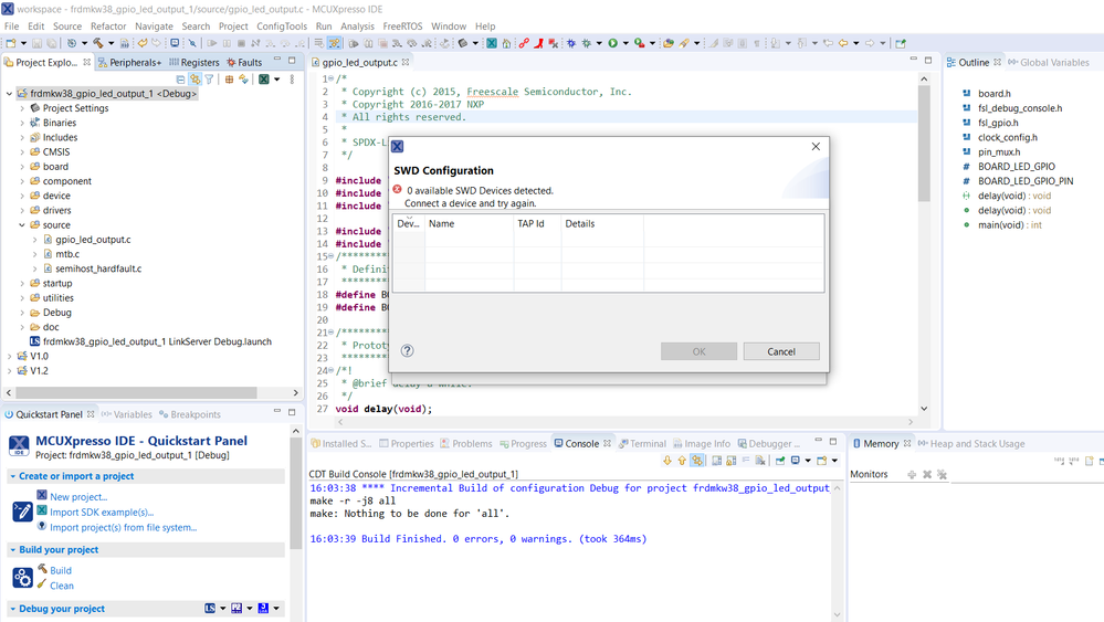

When I try to upload the code on my FRDMKW38 eval board, getting the error message as -> 0 available SWD Devices detected.

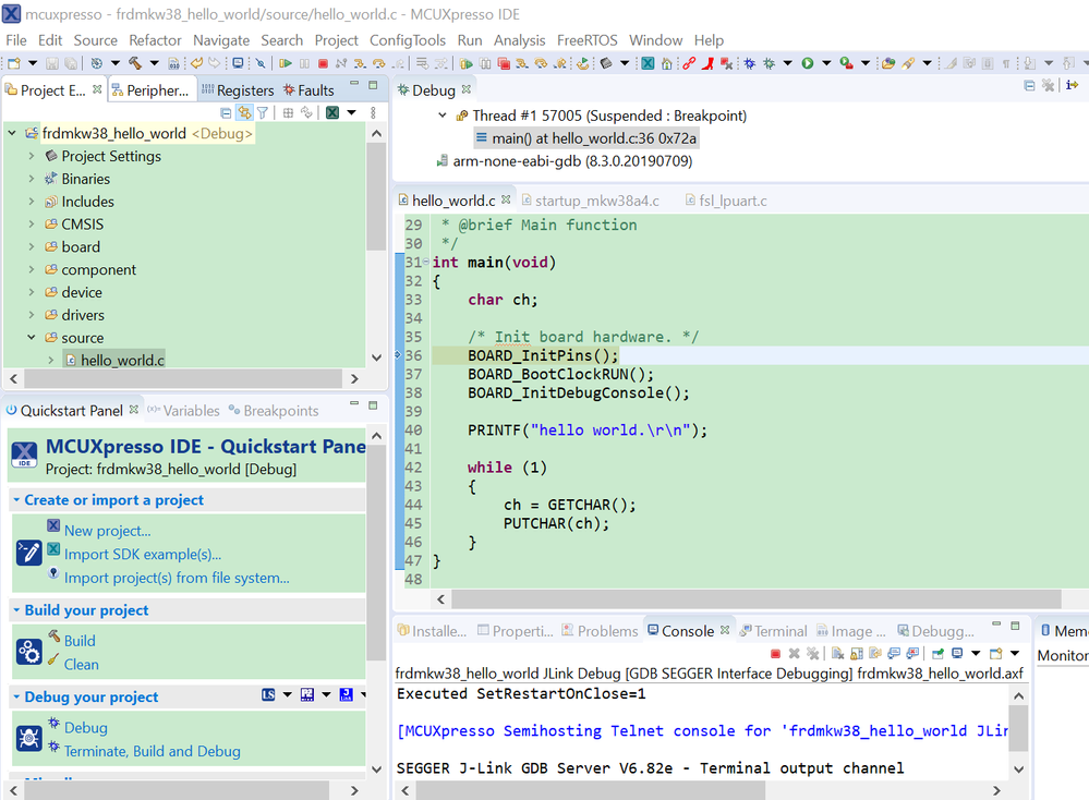

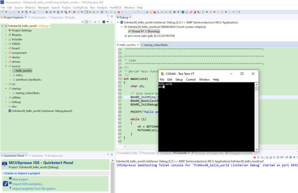

   Please check this picture:
When you import the SDK project, please use the UART instead of the console, then try it again.
If you still have download issue, please also give me your MCUXPresso JLINK debug log, you can find the log like my attached picture:
You can find my log in the attachment, you also can compare your own log with my log.

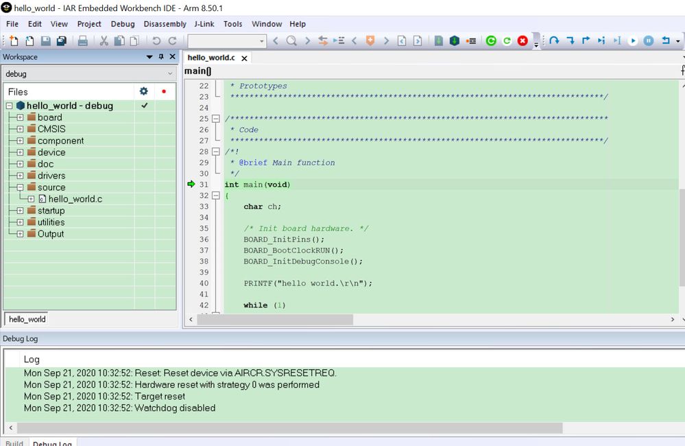

Except MCUXPresso IDE, do you have any other IDE, eg, IAR
The following picture is my IAR project test result, as you know, the SDK also contains the IAR project.

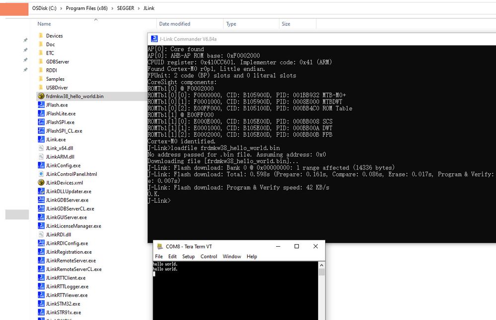

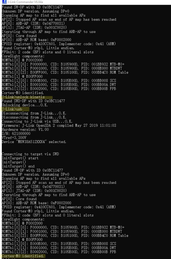

We still have another way, you can download the code without the IDE, we can use the JLINK commander to download the app firmware .bin file directly.
Before you download the code, you can also erase it.
1. Connect the board, and find the arm core
2. use commander: unlock kinetis
to erase all the chip flash
3. commander: usb
to reconnect the chip, and find the ARM core
4. copy my attached frdmkw38_hello_world.bin to the JLINK install path:
C:\Program Files (x86)\SEGGER\JLink
5. use commander: loaderfile frdmkw38_hello_world.bin
You will find the app.bin is downloaded, please check my attached picture.

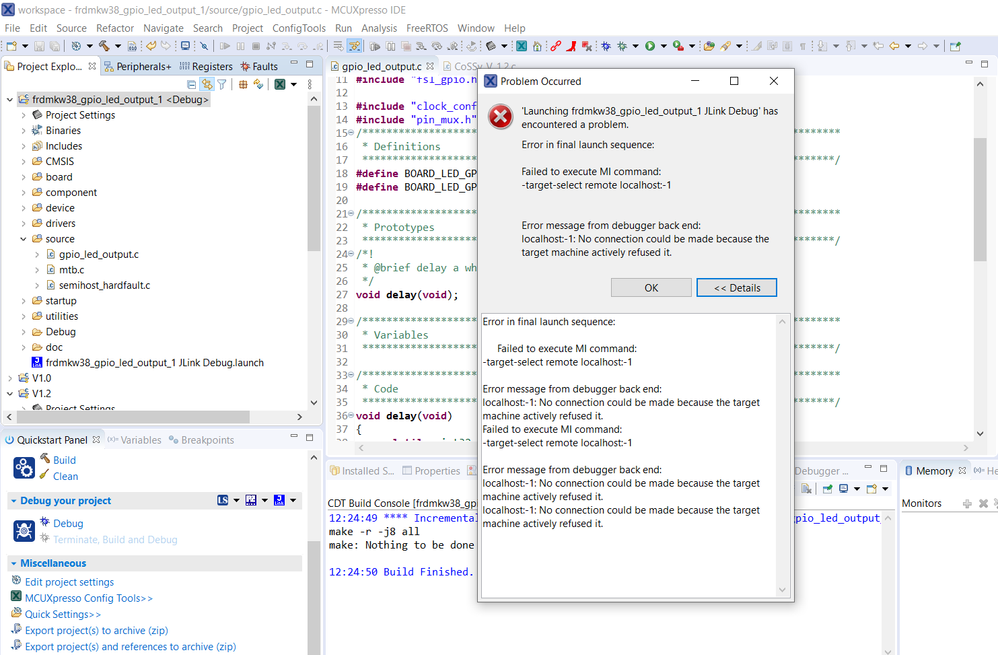

notanivipul
Hi @kerryzhou
Thanks for your reply.
Yes I am using MCUXPresso IDE for frdmkw38 board.
I have attached the screenshots of steps that i am Following, please check if you can find the issues .
Please let me know if you need screenshot of any specific step or any other information.

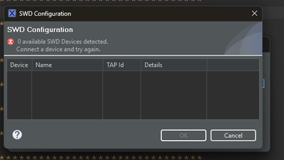

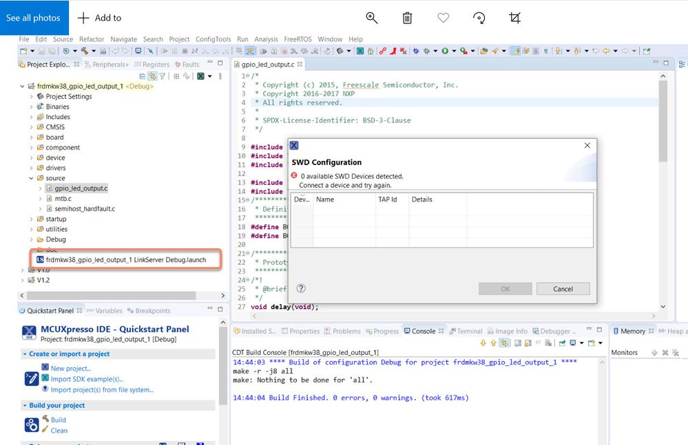

Hi notanivipul
  img3.PNG is also from your side?
  That can find the DAPLink CMSIS-DAP.
   If it is not your picture, please just img4.PNG is yours.
   Then, please delete the frdmkw38_gpio_led_output_1 LinkServer Debug.launch, clean the project, and debug it again.

notanivipul
Hi @kerryzhou
Yes, img3.PNG is from my side.
I deleted frdmkw38_gpio_led_output_1 LinkServer Debug.launch as you said and and tried debug again after cleaning the project but I am still getting the same error.
56,417件の閲覧回数

ok, now, open the JLINK commander from your PC start area, check the following picture and follow it:
Now, can you find the Cortex-M0 like me?
Please check it?
Then you can delete your .launch , and use the JLINK to download the code again.
You can find I also can use the JLINK to download code.

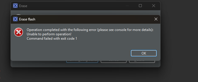

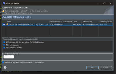

Transidico
Good morning,
I am using the frdm-mcxc242.
I tried to program the flash using the console, but the console crashed and then could no longer find the device.
If I try to delete the .launch file, I can see the target, but then it doesn't work.
I tried both a mass erase and reloading the firmware on the LPC55S69 using jp1. Neither worked.
Could you advise me on what to do?
Thank you in advance.
