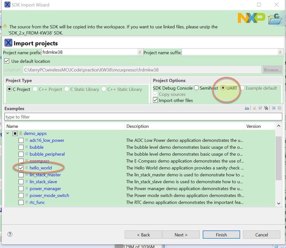

   What's the SDK version you are using? SDK2.6.7?
   Please check this picture:
When you import the SDK project, please use the UART instead of the console, then try it again.
If you still have download issue, please also give me your MCUXPresso JLINK debug log, you can find the log like my attached picture:

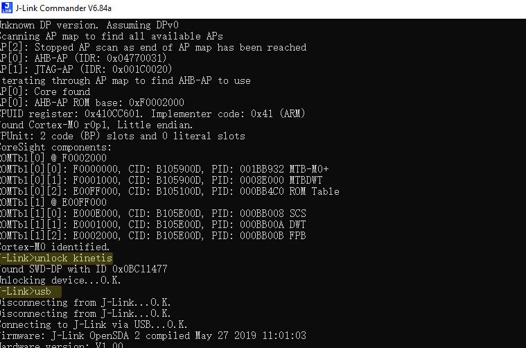

We still have another way, you can download the code without the IDE, we can use the JLINK commander to download the app firmware .bin file directly.
Before you download the code, you can also erase it.
1. Connect the board, and find the arm core
2. use commander: unlock kinetis
to erase all the chip flash
3. commander: usb
to reconnect the chip, and find the ARM core
4. copy my attached frdmkw38_hello_world.bin to the JLINK install path:
C:\Program Files (x86)\SEGGER\JLink
5. use commander: loaderfile frdmkw38_hello_world.bin
You will find the app.bin is downloaded, please check my attached picture.
