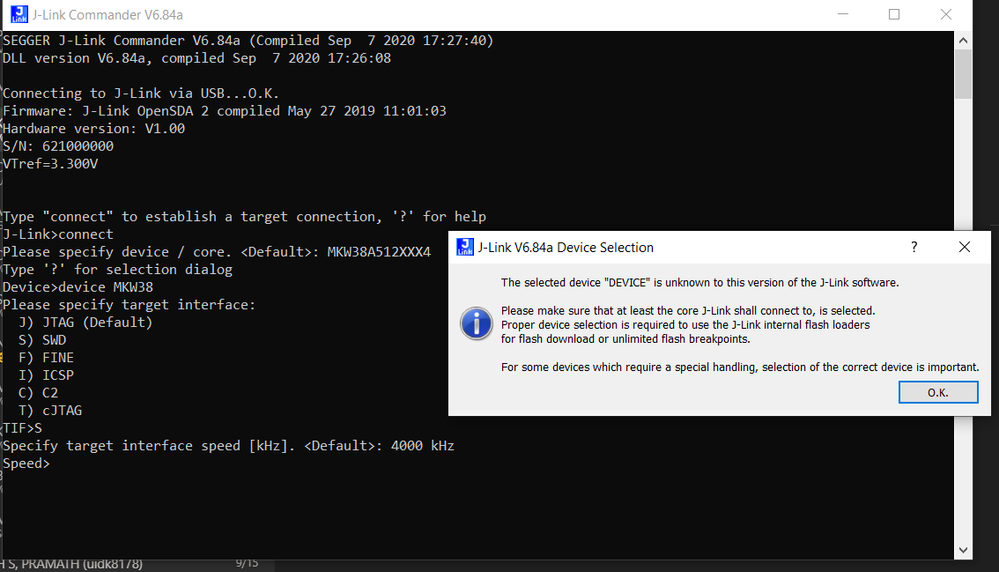

1. Download the JLINK driver and install it.
https://www.segger.com/downloads/jlink/JLink_Windows.exe
Download the JLINK bootloader firmware: 53_OpenSDA_FRDM-KW38.bin , will be used later.
 https://www.segger.com/downloads/jlink/53_OpenSDA_FRDM-KW38
 2. Enter bootloader mode
     Power off the board, press the reset button SW1, and hold on it,at the same time, plug usb cable to J11, then release the reset button, now you will find your board is the device named as  "DAPLINKBOOT"
3. Send 53_OpenSDA_FRDM-KW38.bin to your "DAPLINKBOOT", and wait the sending finished
4. Power off the board and power on it again.
ok, now, open the JLINK commander from your PC start area, check the following picture and follow it:
Now, can you find the Cortex-M0 like me?
Please check it?
Then you can delete your .launch , and use the JLINK to download the code again.
You can find I also can use the JLINK to download code.

notanivipul
Hi @kerryzhou
Thanks for your reply.
Answering to your first question -> No I haven't made any changes to the hardware after I got it.
I am also using MCUXPresso version V11.2.0 like you.
As mentioned I updated the onboard debugger to JLINK. Following are the screenshot and I am stuck where I have to enter the speed
Please let me know what steps are to be followed next.
Thanks and regards
Vipul

kerryzhou
Hi notanivipul
   Just press ENTER, use the default speed is OK.
Best Regards
Kerry
