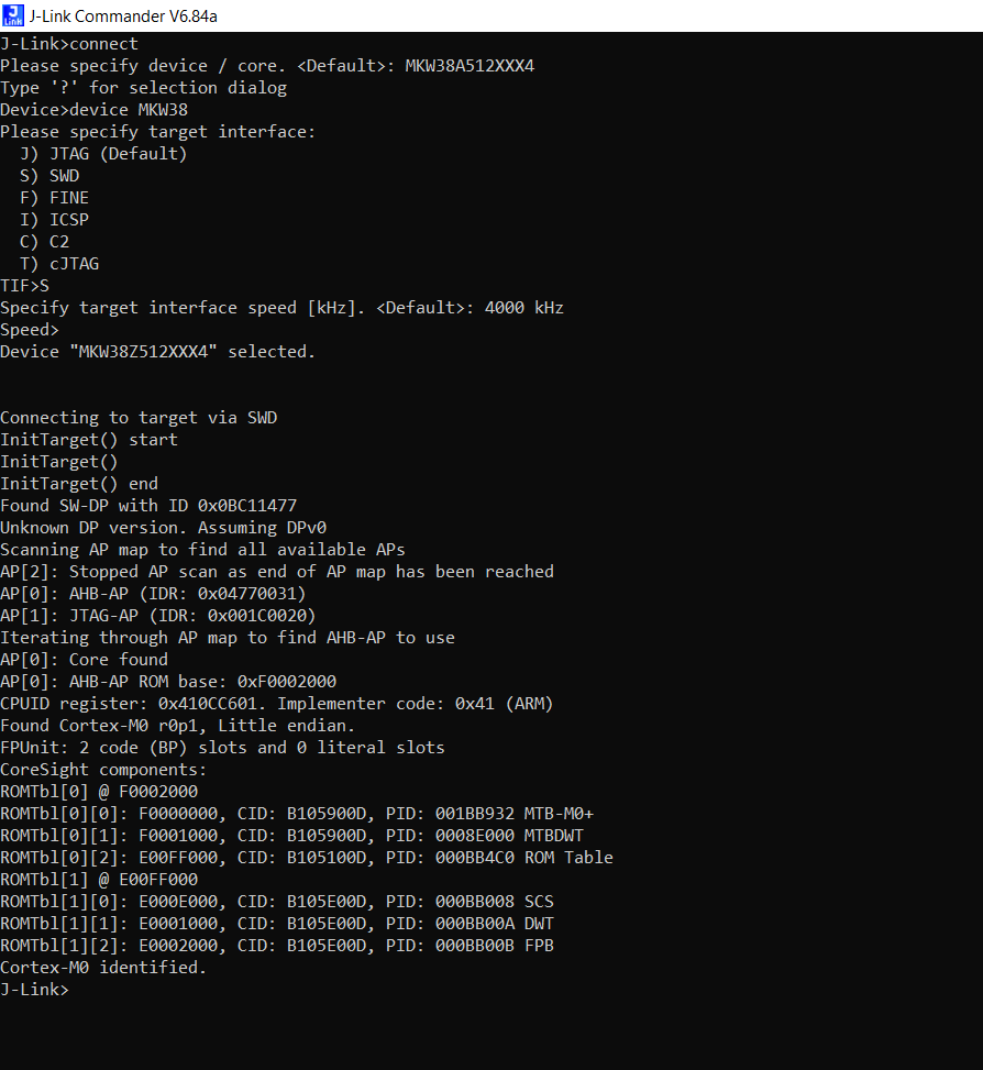

   We need to update your onboard debugger to JLINK, then use the JLINK commander to check your core with the SWD interface at first.

ok, now, open the JLINK commander from your PC start area, check the following picture and follow it:
Now, can you find the Cortex-M0 like me?
Please check it?
Then you can delete your .launch , and use the JLINK to download the code again.
You can find I also can use the JLINK to download code.
Please also let me know your MCUXPresso version, I am using V11.2.0

notanivipul
Hi @kerryzhou
Thanks for your reply.
Answering to your first question -> No I haven't made any changes to the hardware after I got it.
I am also using MCUXPresso version V11.2.0 like you.
As mentioned I updated the onboard debugger to JLINK. Following are the screenshot and I am stuck where I have to enter the speed
Please let me know what steps are to be followed next.

39,553件の閲覧回数
notanivipul
Hi @kerryzhou
I followed the steps as you suggested.
Following are the screenshots, but I am still unable to upload the code.
Please let me know what could be done next.
Thanks and regards
Vipul
39,533件の閲覧回数
kerryzhou
Hi notanivipul
  Your JLINK already can find the ARM core, that's strange you still can't use the MCUXPresso IDE to download.
