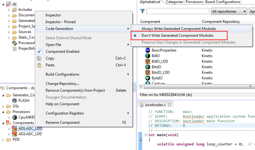

I am using KDS v3.0.0 and have been using PE a lot for all the peripherals on a K65 uC.  I find sometimes that when I change a setting a save it that it doesn't always rebuild.  I found changing the baud rate in my UART component especially prone to this.  Is there a way to force KDS to tell PE that something changed and have it rebuild so that the changes are reflected in the Generated_Code?

Hi Kevin,
I have not seen something like this.
if you change a setting, and you generate code, and it does not build the changed files, then this would be a bug.
Could you report other details? Have you generated code?
Note that there is a setting to disable code generation (see How to Avoid Slow Processor Expert Projects | MCU on Eclipse ) in case you want to do it manually. Maybe you have enabled that setting, and code is not generated after you have changed something?

Hello Kevin,
After you change the code , if you do not want the PE change the code you write , you can select ""Don't Write Generated Component Modules"
thus , when rebuild the project , the code you write won't disappeared .
