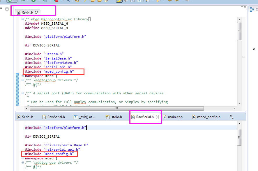

Here is the error I get
With a simple HelloWorld code:
../main.cpp:3:23: error: call to 'mbed::Serial::Serial(PinName, PinName, const char*, int)' uses the default argument for parameter 4, which is not yet defined
Serial pc(USBTX, USBRX); // tx, rx
Code:
#include "mbed.h"
int i=0;
int main() {
    while(i<=10){
        pc.printf("Hello World!\n");
        i++;
I am pretty sure it is because KDS is not getting the mbed libraries. I don't know how to do that. I export the mbed project from the mbed online IDE to a KDS format. Then import in in KDS. Could not be that easy huh...
I hoped the source for mbed was being exported with the project and KDS would build it all.
I know other people had work done on GCC4mbed earlier. Do we still need to do that kind of work to export / import mdeb to KDS?
-Jack

Hello Jack,
- Firstly thanks for your sharing .
I also refered to your simple code did an experiment, yes , when build on KDS, it shows some error.
This is for in the file of "RawSerial.h" and "Serial.h" use the macro definition "MBED_CONF_PLATFORM_STDIO_BAUD_RATE  " , it defined in the header file "mbed_config.h",
while the two file have not includes it .
- So the workaround is include the "mbed_config.h" :
Then build, download , it can work well , please have a try .
Hope it helps
Alice

jacksilb
Hi Alice,
Good news it worked.
I was able to get an example to work including RTOS from mbed.
I have been working on other projects. I will get back to it  For some other exports still have some other errors. Definitively this is not a plug and play as one may think.
