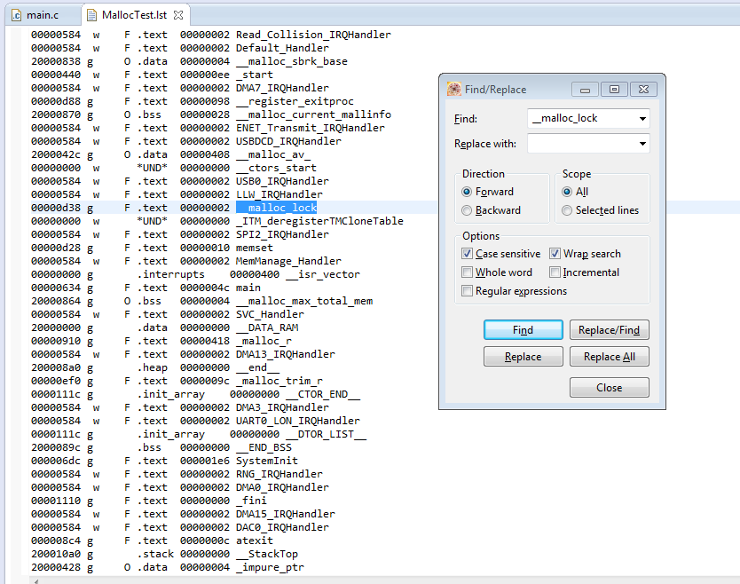

Why KDS::newlib::malloc() does not call __malloc_lock/unlock functions? Was locking support compiled out?
I can see malloc_r in the map file but no reference to locking functions.
Sergei

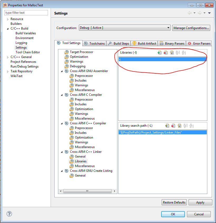

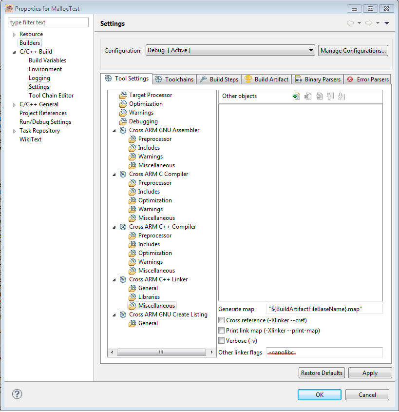

Hi Sergei,
If you remove nanolibc from the linker options and simply link in libc, then you will find that malloc/free calls __malloc_lock/unlock. Hopefully this helps you.
Martyn

martynhunt
Hi Sergei,
Martyn

Do not have a demo project but here are 3 easy steps to reproduce:
1. In KDS import hello_world_frdm22k demo project from KSDK_1.1.0/demos/hello_world/kds/frdmk22f
2. Add calls to malloc/free somewhere in main(), e.g.:
      void *p;
      p = malloc(10);
      if(p)
             free(p);
3. Check map file for presence of locking functions:
    grep malloc_lock hello_world_frdmk22f.map
Or use text editor if grep is not available.
You will see that locking functions are not there.
