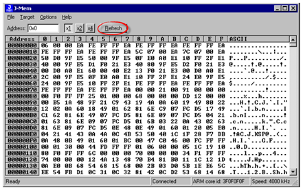

11,319 Views
ivadorazinova
Dear kornwut chalermmeekol,
As Jorge mentioned, you can watch variables via expression view in KDS, but you must stop the program. It is not real-time routine.
The differences between J-Trace and J-Link is that J-Trace periodically halt cpu and read data from registers.
Here are the main differences, while ETM Trace is shortcut for Embedded Trace Macrocell, CoreSight Trace Macrocells - ARM
and ETB is shortcut for Embedded Trace Buffer, small, circular on-chip memory area where trace information is stored
during capture. It contains the data which is normally exported immediately after it has been captured from the ETM.
There are a lot of these tools, which you can use for the watching variables for J-Link.
Another one is e.g. J-Mem Memory Viewer, but it is for J-link too, because you must always stop the program
You can also use J-scope, it is something like Freemaster for J-link is a free-of-charge software to analyze and visualize data on a microcontroller in real-time, while the target is running.
You just choose target device, target interface and speed and its elf file.

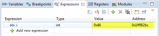

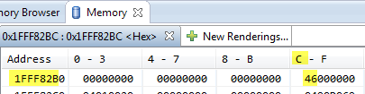

Jorge_Gonzalez
Hello kornwut chalermmeekol:
Yes, it is possible to read-write variables while debugging with Segger J-Link. You can use the "Expressions" view:
Or the "Memory" view:
Of course write operations are only valid for RAM space.
Regards!,
