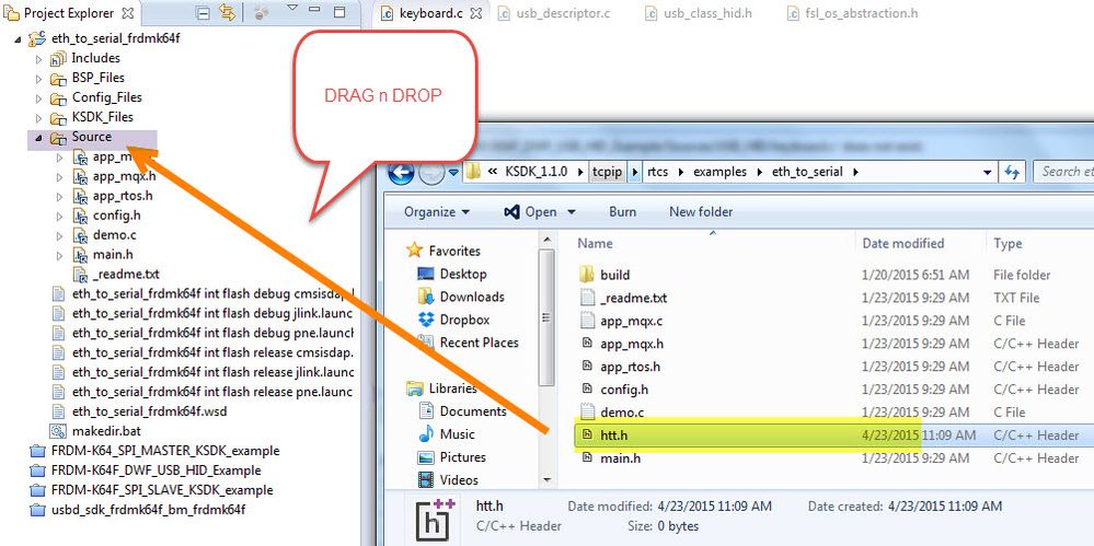

     i am using frdmk64f120 controller, KDS 2.0 IDE and KSDK 1.1.0 example. i want to create .c and .h header file in ethernet_to_serial project. when i tried its showing following error.

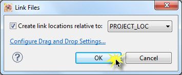

The example projects of the KSDK 1.1.0 have linked folders, this means that the folders are not physically present on the project folder. For this reason is why you cannot add files to the folders because are not there in the project folder.
You can do it in the next way.
Create a new file under the folder where the main.h is (please check file path) then you can drag and drop the new file and the next message will pop up
you can select ok to link the file, this means that a virtual copy will be created into the project folder but the location is different.
