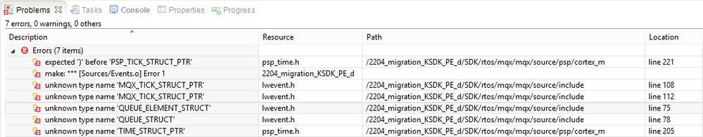

I created a project using KSDK/PE with MQX, 1 task added, 1 event created, but when compiling:
when i go into psp_time.h, and right click PSP_TICK_STRUCT_PTR to open declaration, KDS can find the declaration in the mqx.h.
So it's the problem of compiler settings?
Find my project in attach

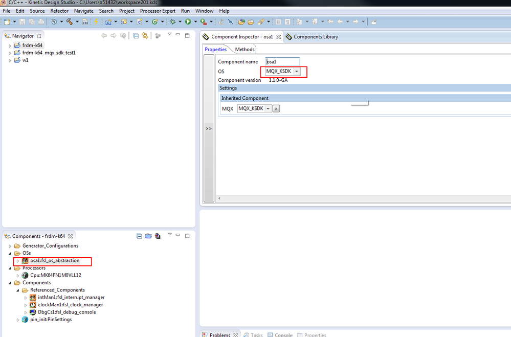

Hello ,
When  use MQX_KSDK,  it needn't add the mqx_ksdk component,  we  only need choose here :
this function is equivalent to MQX_KSDK.  There are all the OS the KSDK concluded, we can refer to our need select.
Please see the attachment , it is a project i create on my side , you can try it on your side .
Alice
