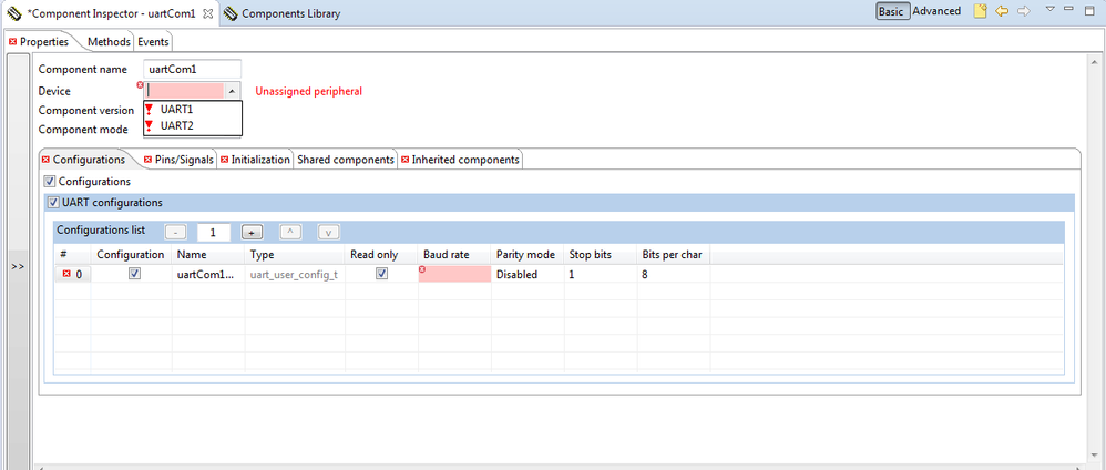

I would like to use UART0 over the FRDM-KL25Z with KSDK (v1.3.0) and PEx but when I added fsl_uart component, it seem that UART0 is not in Device selection

I already use UART1 and UART2 for others tasks.

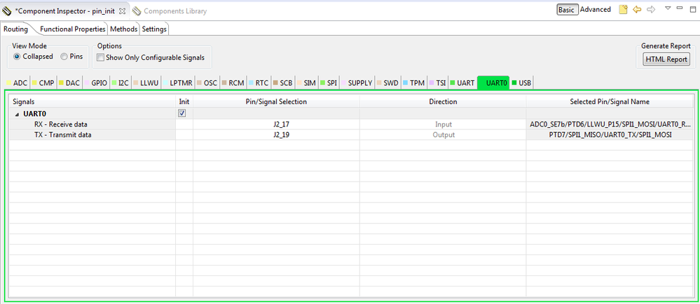

Also, I properly configured UART0 pin with PinSetting PEx component.

Maybe I could use UART0 directly with KSDK HAL methods but the question is :
Why can't I use UART0 over fsl_uart PEx component ?

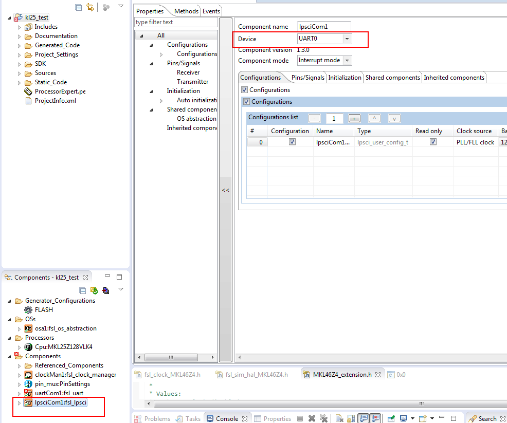

Hello Maxime,
For the UART0 can also worked on Low power mode , for example stop mode , wait mode ,
so in the sdk+pe lib,  make one PE component for itself "fsl_lpsci", if you want use UART0,
please add this component .

Ok, I didn't see it. I tried and UART0 is rolling fine now. :smileycheck:
Thank you Alice.
And by the way, for anyone arrived here with same question, this post explain why fsl_uart can't use UART0
UART module 0 from kl25z128m4 is missing in KSDK + PE?
Carlos_Mendoza answered (21-août-2015) :
" ... This is because the UART modules are supported by different HAL/drivers, the UART0 module is supported by the LPSCI HAL/driver and the UART1 and UART2 modules are supported by UART HAL/driver ... "

Hello ,
Yes, as to the UART0 can work in low power mode , while UART1 and UART2 can not ,
so the driver is different .
