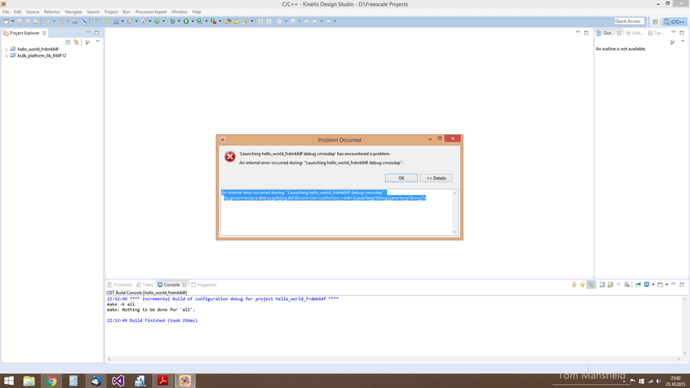

getting An internal error occurred during: "Launching hello_world_frdmk64f debug cmsisdap". ilg.gnuarmeclipse.debug.gdbjtag.dsf.GnuArmServicesFactory.<init>(Ljava/lang/String;Ljava/lang/String;)V error when try to debug hello world demo

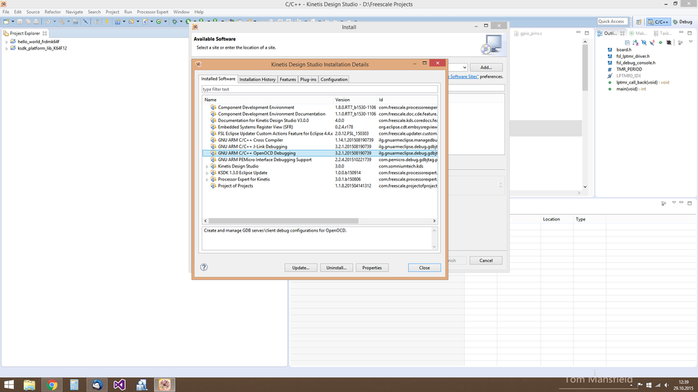

Hi Erich ,
The plugins are as follow , Anyway I have solved my problem by using PE Debugging , now it works

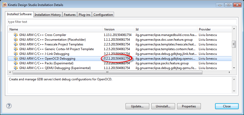

Could it be that you have updated the GNU ARM Eclipse plugins?
This is what I have and is working for me:
Note that there had been a GNU ARM Eclipse update which breaks at least the segger J-link debugging (I had not observed that it breaks OpenOCD).
Have a look at Unable to Debug after KDS Update  which as well includes the patch/workaround.
Can you apply that patch and check if this helps?
I hope this helps,
Erich
