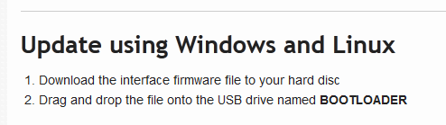

Illustrated Step-by-Step Instructions: Updating the Freescale Freedom Board Firmware | MCU on Eclips...
Installed 0226_k20dx128_k64f_0x5000.bin by copy paste to H:\BOOTLOADER

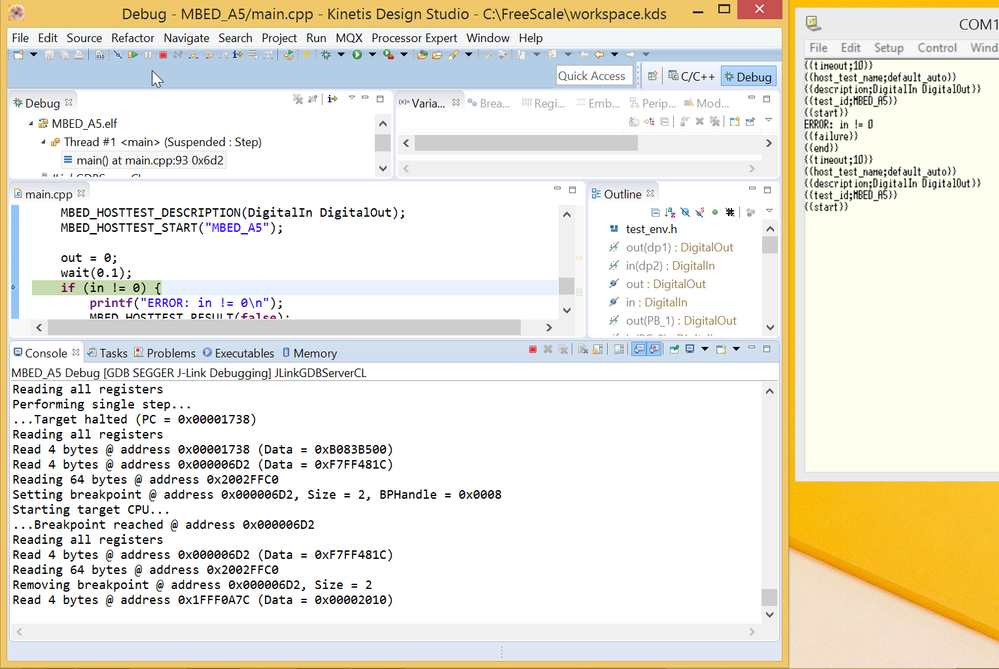

An internal error occurred during: "Launching MBED_A5".
ilg.gnuarmeclipse.debug.gdbjtag.dsf.GnuArmServicesFactory.<init>
(Ljava/lang/String;Ljava/lang/String;)V
http://mcuoneclipse.com/2014/04/27/segger-j-link-firmware-for-opensdav2/
Installed JLink_OpenSDA_V2_2015-10-13.bin by copy paste to H:\BOOTLOADER

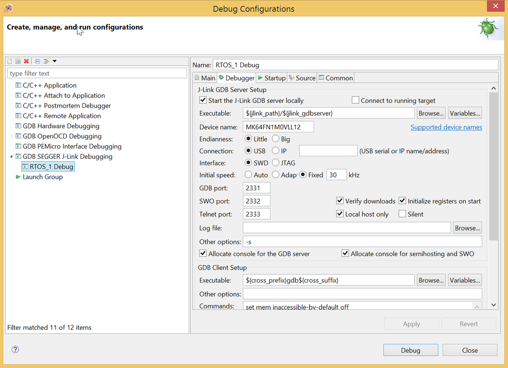

Tried to setup new Debug Configuration:
An error has occurred. See error log for more details.
ilg/gnuarmeclipse/debug/gdbjtag/data/CProjectAttributes
Solution: https://community.freescale.com/thread/363937
Installed two plugins (replacements of existing files)
This enabled the use of JLink_OpenSDA_V2_2015-10-13.bin with Test 4 being part of bsilvereagle's article: (only up to line 7 of main())
Details:{gpio = {pin = PTC16}}
Default:{...}
Decimal:{...}
Hex:{...}
Binary:{...}
Octal:{...}
Which blocks in:
void notify_completion(bool success)
    printf("{{%s}}" NL "{{%s}}" NL, success ? TEST_ENV_SUCCESS : TEST_ENV_FAILURE, TEST_ENV_END);
    led_blink(LED1, success ? 1.0 : 0.1); //Blocked in this function
I would much appreciate guidance for a debugging beginner.

If you want to use the openOCD debug , you can test first Drag and drop the .bin file(the attachment ) onto the USB drive named BOOTLOADER.Then reinsert the USB to have a try .
(The .bin can used on Windows 7, i check the mebd update the driver , it is the same with Linux, so you can try .)

Hello Alice,

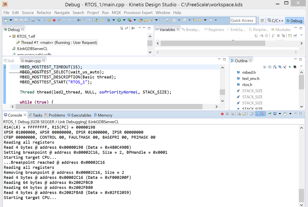

Yes it works with J-Link openSDA debug. OpenOCD did not work with this project or this one Getting Started with Kinetis SDK . Is it faulty?
Kevin.

Hello Alice,

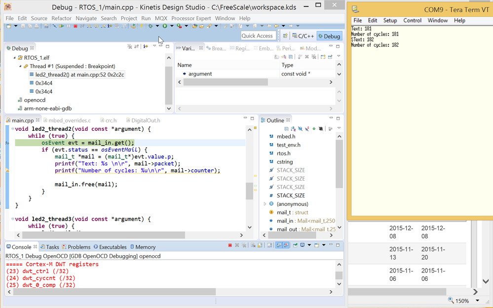

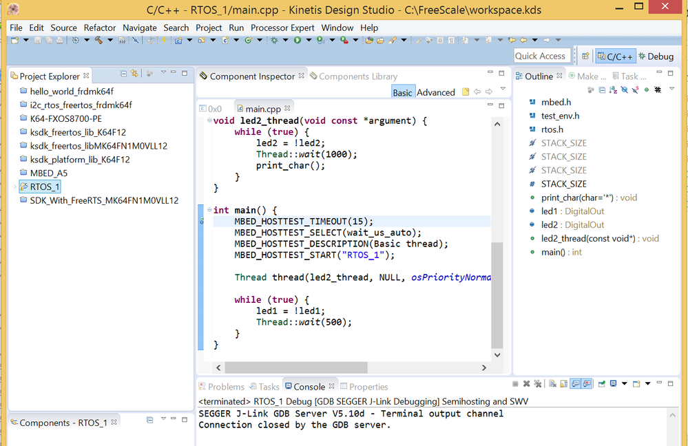

Yes I did get the three firmware packages mixed up. I can now step through this rtos program using OpenOCD:

Thank you for your help.

"An internal error occurred during: "Launching MBED_A5"."- What's the error ?

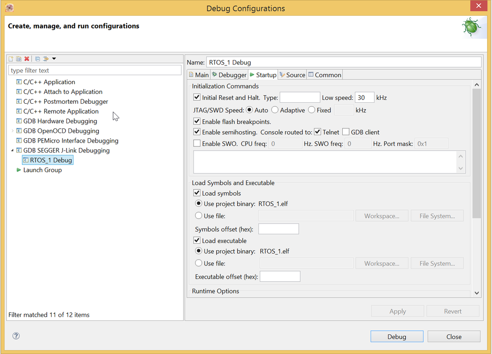

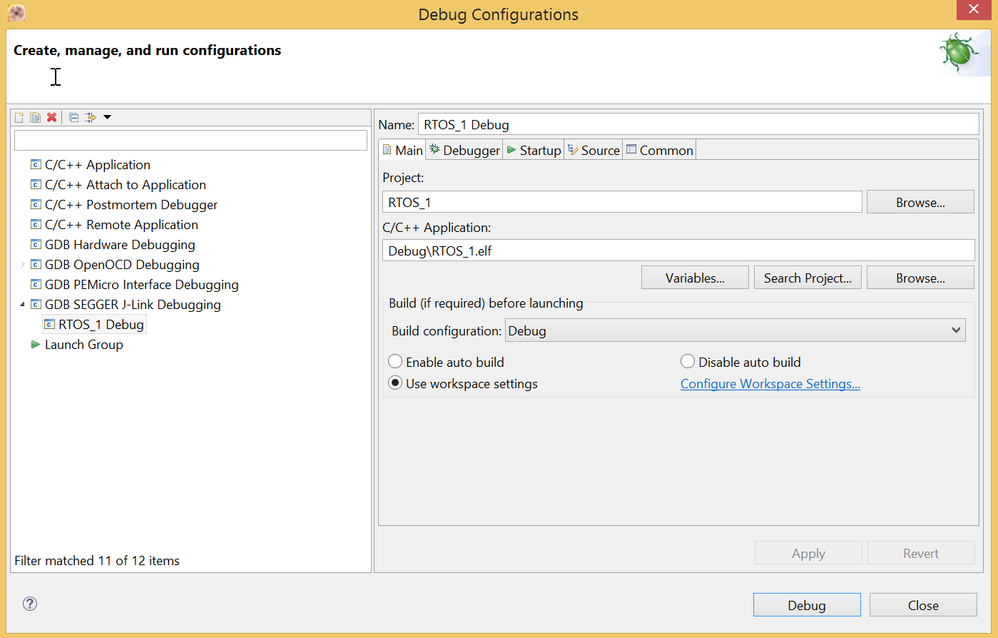

"Tried to setup new Debug Configuration:" - How do you configure the debug ?
"An error has occurred." -- What's the error ?
About the debug on KDS, i recommend you recommend
KDS_Users_Guide.pdf -> 2.5 Debugging Projects ( the DOC is under "Freescale\KDS_3.0.0\doc")
Hope it helps
Alice
6,395 Views
kg1
Hello Alice,
Thank you for your reply. In the bsilvereagle's article I am up to here:
"Run code on K64F
Note: I use the Segger J-Link OpenSDA application for debugging. The K64F by default uses OpenOCD. I believe just pressing the 'Debug' icon while the K64F is plugged in should debug the application. I recommend using the Segger J-Link debugging interface. A post will follow on how to do this."
I tried OpenOCD which failed. Hence "I believe just pressing the 'Debug' icon while the K64F is plugged in should debug the application." is not true. Next I installed  Segger J-Link OpenSDA which does debug a simple test program but the program fails the test.

I will try test number 84 and will include all source code including the mbed libraries:
PS C:\FreeScale\tmp\wsp_kds_3.0.0\mbed> python workspace_tools/project.py -m K64F -i kds -p 84
Copy: Timer.cpp
Copy: TimerEvent.cpp
Copy: librtos.a
Copy: librtx.a
Copy: K64FN1M0xxx12.ld
Copy: main.cpp
Successful exports:
  * K64F::kds   C:\FreeScale\tmp\wsp_kds_3.0.0\mbed\build\export\RTOS_1_kds_K64F.zip
Next I completed the debug configurations:
Here are the main screens of KDS:
This time I immediately clicked Resume at the break point and it worked!
