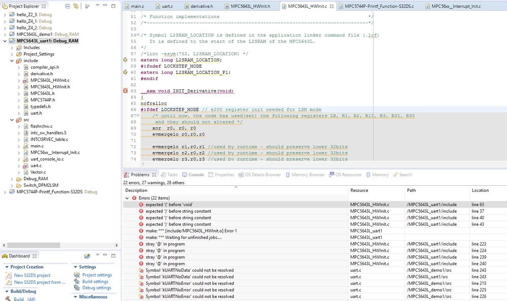

similar issue here with Migration #CCW->S32 project for #MPC5643L. I read AN5282 too (#Migration guide), but no luck so far.
 davidchung‌ maybe any ideas?

I have two suggestions regarding your screenshot:
1) S32DS recognizes "__asm__", not "__asm"
2) You can't use "__asm__" on an entire function.  In my experience you have to use "void INIT_Derivative(void){" and then encapsulate each assembly instruction with "__asm__", such as "__asm__(xor r0, r0, r0);"  Also, make sure that you are using VLE syntax instead of another assembly language like BookE.  The assembly in your screenshot looks more like BookE; VLE looks something like "e_ori 0,0,0".  Another suggestion is to move the assembly function to an assembly (.S) file then, in the C file, do a function call to that assembly function.

nxppower912935
Hi !!
Thanks for your fast reply David, totally agree with 1) and 2)
I set S32DS for VLE.
Have you seen this error before, any ideas what could be done?
I noticed code actually compiles fine without MPC5643L_HWInit.c/.h and debug...how?

Hi Ludwig,
Sorry for the late reply.  I didn't receive a notification so I was not aware you replied to my reply.  Anyway, I'm not too familiar with VLE, so I can't say much on __declspec, but otherwise there doesn't seem to be an error in the error lines themselves.  The "Problems" window does not always point to the root actual error.  Sometimes the compiler detects an error at another line of code that somehow references lines 41, 44, 47.  You can check this in the Console window.  Scan the log for any lines highlighted red.  Those are where the errors pop up and the text around the error can give you a clue as to what line is actually causing the error.  As for it compiling without MPC5643L_HWInit.c, that's because the file is specific to CodeWarrior.  S32DS does not use that file.  All those initializations are now handled in Project_Settings>Startup_Code>startup.S.  Hope that helps.

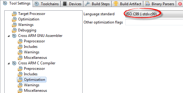

I think you need to check/adopt the compiler settings so it recognizes __asm. Have you set the compiler options to use C99?
Search for "__asm" in this document:
KDS Frequently Asked Questions (FAQ)
I hope this helps,
Erich
8,799 Views
abhilash_vr
Erich, I tried this but didnt work :smileysad:
