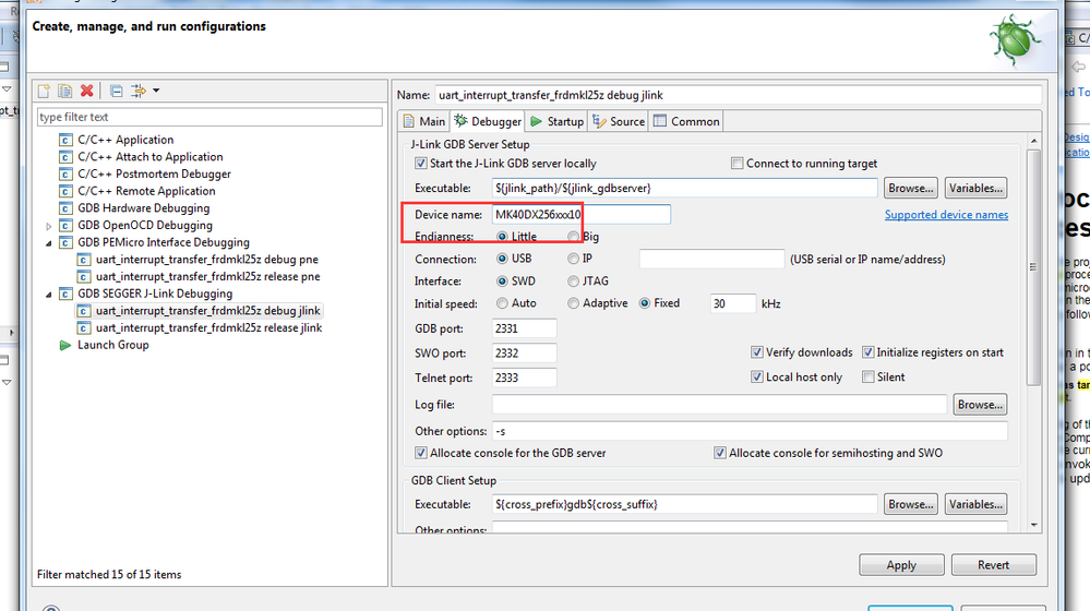

I am using Kinetis Design Studio 3.2 with KSDK 1.3 to work on Kwikstik K40 Rev 5.0.
If I create a new KSDK1.3 project, Use MQX_RTOS, Generate Code and Debug, I can Debug the project for the first time. If I try to Debug for the second time and later on I get the error as below.
"WARNING: CPU could not be halted
ERROR: Could not connect to target.
Target connection failed. GDBServer will be closed...Restoring target state and closing J-Link connection...
Shutting down..."
I could build the project without any issues. I have attached the screenshot for reference.
I am stuck with this issue for more than 2 weeks. Your help would enable me to move forward.

Hello Mahendran,
- Please first check the Device name :
-Please delete the .metadata folder under workspace , the re-open KDS to have  a try.
- If still can not work well , please create a simple bareboard project to check whether it can work well.

Dear Alice,
I changed the device name.
I tried the following options with same result as I was getting before.
1. Deleted .metadata and tried Debugging.
2. Created Bare Metal project without MQX_KSDK and tried Debugging.
One silly clue I have, that is when I turn ON the laptop first time on a day, KDS debug successfully. Later, even if I restart the laptop on the same day, no success.
What could be the one that I am missing in the process?

mahendranmanoha
Hi Alice,
I created SDK for MK40DX256xxx10 with KSDK 2.0 separately with MCUXpresso and crreated a new project in KDS 3.2 referring to the folder.
I could successfully Build, Debug and Run the project from KDS 3.2 on Kwikstik K40.
I reckon KSDK 2.0 does not support MQX. Is there a way I can develop MQX projects with KSDK 2.0 or I should use only KSDK 1.3?
Mahendran.
