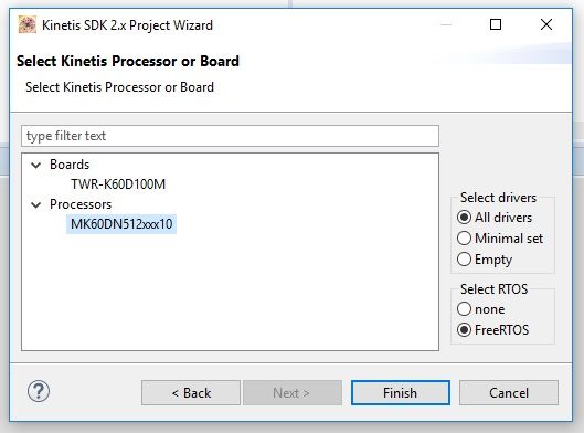

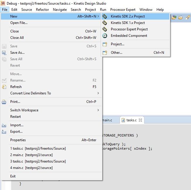

shanescott
Hi Jennie,
For some reason my "new project" wizard is not quite the same as yours.  If I select the same icon as you show, it looks like this:
In order to see the option for KDSK2.0 projects I have to use the "file->new" menu which looks like this:
This does allow me to select a device instead of the Tower:
but I still get the crash on halting.
Also, Your video does not show the situation I am seeing because you are stepping up to the point where the RTOS scheduler is started but not past it.  To duplicate my issue just select the "resume" button and then the "suspend" button.
Shane
