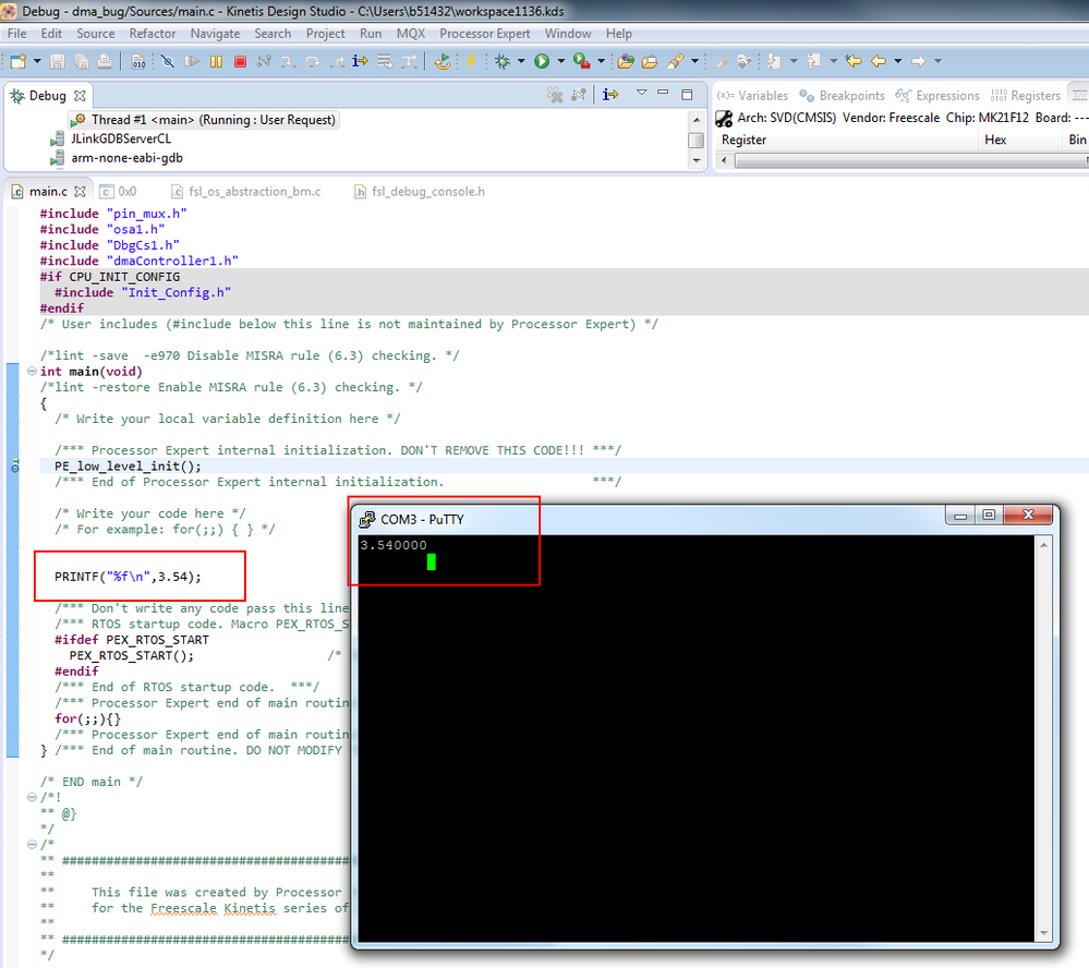

@Hello JIM,
I create one KSDK+PE project about k22 , print the float data to terminal of PC,
it can work well . About the project please see the attachment .
We need define the "PRINTF_FLOAT_ENABLE" macro at the properties:
Hope it hleps
Alice
