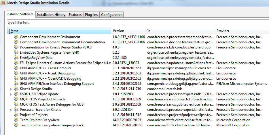

q7Nhaj
I listed my compiler setting on  Apr 18, 2016 8:00 AM as:
arm-none-eabi-gcc -mcpu=cortex-m4 -mthumb -mthumb-interwork -mfloat-abi=hard
-mfpu=fpv4-sp-d16 -Og -fmessage-length=0 -fsigned-char -ffunction-sections
-fdata-sections -fsingle-precision-constant -Wunused -Wuninitialized
-Wmissing-declarations -Wlogical-op -Waggregate-return  -g3 -nostdinc
-D_AEABI_LC_CTYPE=C -D__STRICT_ANSI__=1 -D_DEBUG=1
-std=gnu11 -Wmissing-prototypes -Wstrict-prototypes
-fno-strict-aliasing -fms-extensions -finline-functions
My program compile, linked and run fine. I have a large amount of floating point math in this program and It's all is working fine. My problem is with the debugger first I have no floating point register display.

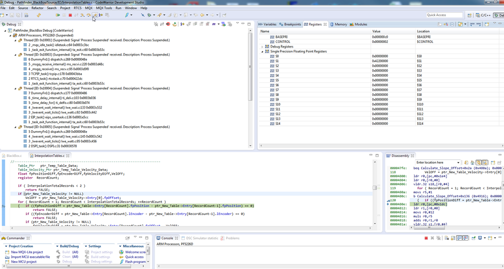

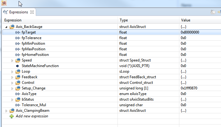

The old compiler Version 10.6 I had floating point register
listed after the control register. I the compiler version 3.2 there are no
floating point register listed. I the Expressions windows all float are listed
as hex number very hard to interpreter.
pastedImage_1.png'

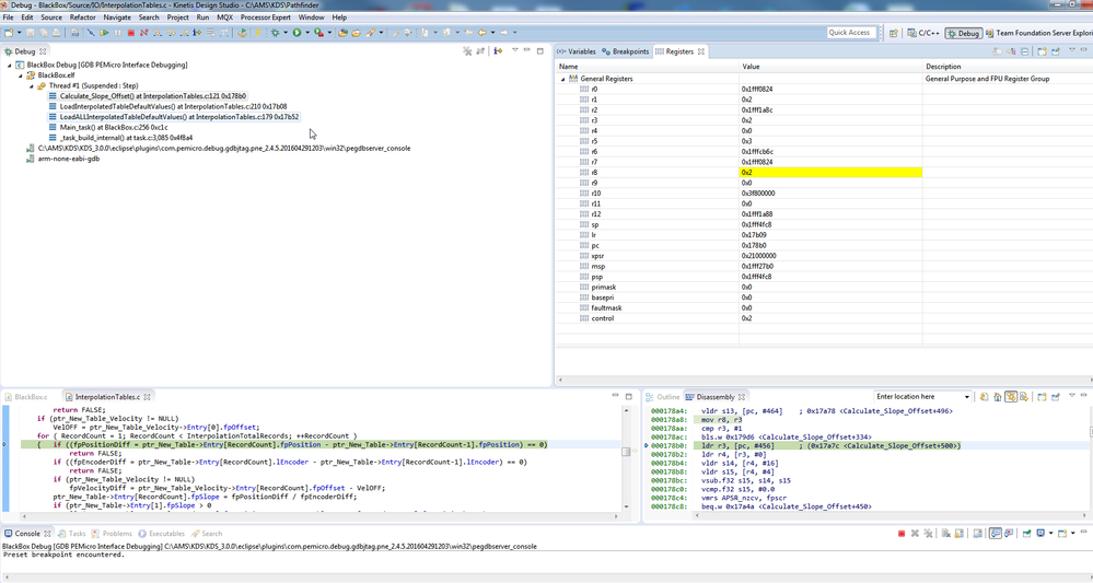

The second problem is when I set a break point in a subroutine that passes a float on the stack the debugger will crash when the break is encounter. I think the debugger is trying to read for float that was passed on the stack and get an error.
console window:
"GCC-4-8-build/src/gdb/gdb/regcache.c:178: internal-error:
register_size: Assertion `regnum >= 0 && regnum < (gdbarch_num_regs (gdbarch) + gdbarch_num_pseudo_regs (gdbarch))' failed."
These problem just make debugging harder. THis is the display from version 10.6 with floating point register.

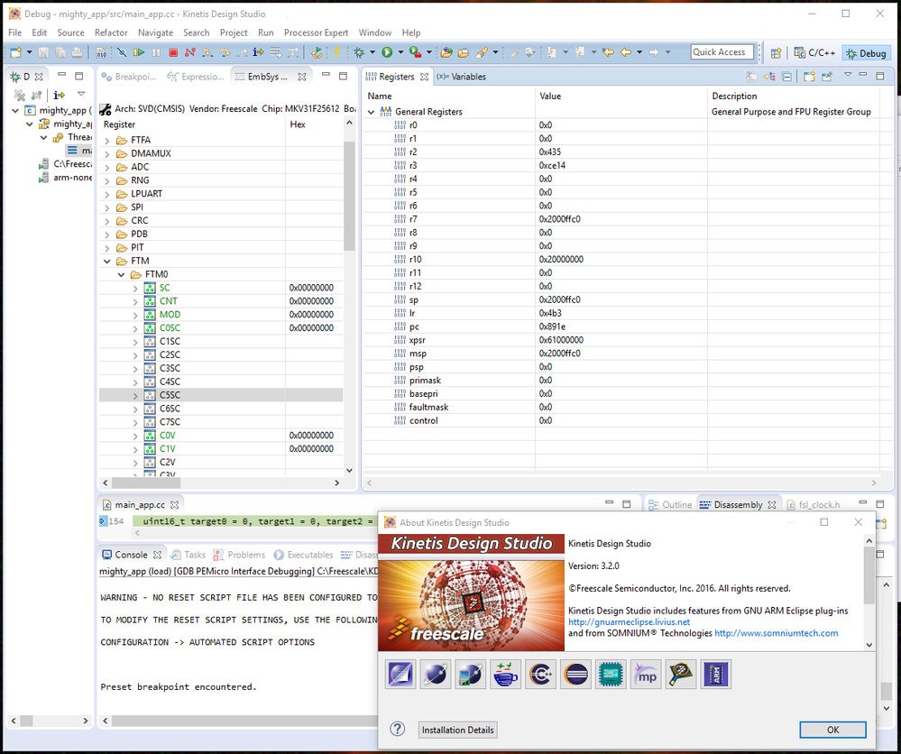

dan_teodorescu
I am working on optimizing in assembly a function that uses the FPU on a Kinetis KV31 (Cortex M4F) using KDS 3.2.0. I would like to verify the code by stepping through the instructions and inspecting the regular ARM registers (R0 - R15) and the floating-point registers (S0 - S31). After doing extensive online searching and looking through the KDS help, I have not found out a way to display any of the single precision registers S0 - S31 using the debugger (PE OSBDM/OSJTAG), in either Register View, EmbSys Registers View, or any other view. The debugger otherwise seems to be working fine and I can see the main core registers and peripheral registers for my target MCU.
Looking at the disassembly view, I can see that the executable includes FPU instructions (eg. vldm, vmul, etc.) and the core executes them without generating any exceptions - the FPU must be enabled and functional.
Compiler Command: C:/Freescale/KDS_v3/Toolchain/bin/arm-none-eabi-gcc -mcpu=cortex-m4 -mthumb -mfloat-abi=hard -mfpu=fpv4-sp-d16 -O0 -fmessage-length=0 -fsigned-char -ffunction-sections -fdata-sections -Wall -g3 -D"CPU_MKV31F512VLL12" -DARM_MATH_CM4 -I./include -std=gnu99 -DPRINTF_ADVANCED_ENABLE=1U -DFSL_RTOS_FREE_RTOS -DSDK_OS_FREE_RTOS -c -o "src/line_optimized.o" "src/line_optimized.s"
Linker Command: C:/Freescale/KDS_v3/Toolchain/bin/arm-none-eabi-gcc -mcpu=cortex-m4 -mthumb -mfloat-abi=hard -mfpu=fpv4-sp-d16 -O0 -fmessage-length=0 -fsigned-char -ffunction-sections -fdata-sections -Wall -g3 -D"CPU_MKV31F512VLL12" -DARM_MATH_CM4 -I./include -std=gnu99 -DPRINTF_ADVANCED_ENABLE=1U -DFSL_RTOS_FREE_RTOS -DSDK_OS_FREE_RTOS -save-temps -T "link/MKV31F512xxx12_flash.ld" -Xlinker --gc-sections --specs=nano.specs -specs=nosys.specs -Xlinker -z -Xlinker muldefs -Wl,-Map,"mighty_app.map" -o build/mighty_app.elf src/drivers/fsl_dac.o src/drivers/fsl_clock.o src/drivers/fsl_lpuart.o src/drivers/fsl_smc.o src/drivers/fsl_uart.o src/board/board.o src/board/clock_config.o src/board/pin_mux.o src/startup/startup_MKV31F51212.o src/startup/system_MKV31F51212.o src/utilities/fsl_debug_console.o src/generator_thread.o src/line_optimized.o src/main_app.o
Has anyone had luck accessing Cortex M4F FPU working registers (S0 - S31) through the KDS 3.2.0 debugger using PE OSBDM/OSJTAG?
Thank you,
Dan

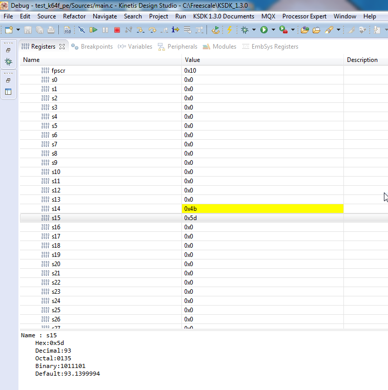

I could monitor the local variable in the Variables window and also see the Register s14 and s15 being used for floating point.

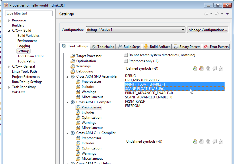

I used the HelloWorld demo project and to have the PRINTF working for %f float stuff I had to make following change in the properties:
Then recompiled and ran.

dan_teodorescu
Hi David,
I followed your advice but I still can't get the FPU registers to show up in the Registers view as you have in your screen shot. Here is what my IDE looks like - peripheral registers on the left and core registers on the right.
Do you remember if you had to make any IDE changes to enable FPU registers to be included in the Registers view?
The alternative of using printf or similar console printing functionality from assembly language is not as convenient when stepping through code.
Thank you for your support,
Dan

DavidS
Hi Dan,
Weird.  Everything I try (creating new KSDK_v2 project for KV31Z or using existing KSDK_v2 projects) has the floating point registers in the Register window.
Did you try using the hello_world project as a test?  You picture looks like you might have created a new project.
You might try closing that tab and re-opening by going to Window->Show View->Registers .
What Windows OS are you running?  I'm on Windows 7 Professional 64-bit.
UPDATED:
Just ran another test.  If I am using PEMicro USB MultiLink debugger hardware, I do not see the floating point registers listed in the Register window.
When I use the Segger JLink or Segger OpenSDA firmware for debugging, I see the floating point registers listed in the Register window!
I'm guessing you are using PEMicro OpenSDA firmware or debugger???
David

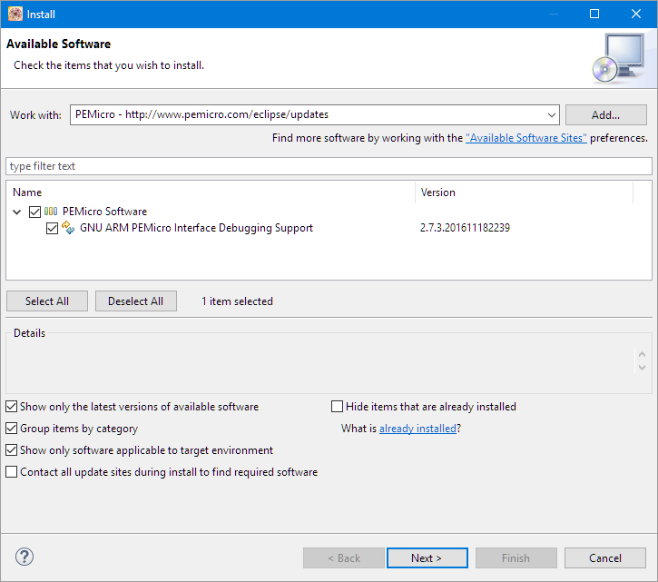

BlackNight
Hi Dan,
P&E has released the update:
I hope this helps,
Erich
20,041 Views

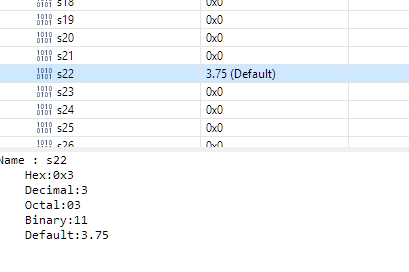

dan_teodorescu
Hi Eric,
I downloaded this update and I can now see registers s0 - s31 listed under the General Registers section, and this is very useful for debugging. One minor nit is that the plugin can only display the values in Hex, Decimal, Octal, Binary and Default (which seems to be Decimal). These representations options are fine when working with fixed point values, but cumbersome when working with floating point values. I will likely keep a browser tab open to a hex to float conversion site such as this http://babbage.cs.qc.cuny.edu/IEEE-754/, which can convert hex based notation to the equivalent IEEE-754 floating point value.
If you happen to know of a better way to working with floating point registers please add a comment to this thread.
Thank you for your support.
All the best,
Dan
20,041 Views
BlackNight
Hi Dan,
have you tried the 'default' format?
Related to that, see Debugging Variables in Hexadecimal with Eclipse | MCU on Eclipse  and Show Floating Point Variable Bytes in Eclipse CDT | MCU on Eclipse .
I hope this helps,
Erich
20,041 Views
dan_teodorescu
Hi Erich,
I restarted KDS earlier today and now I do see floating point values being displayed when I select the "default" view.  At this point it seems like I have full visibility into the MCU (registers and peripherals).
Thank you for the quick response!
Dan

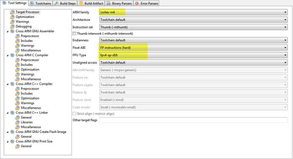

Otherwise, it could be that your application might not be compiled with the correct floating point options? At least gdb complains about the register numbers.
This is what I have:
So these options should result somthing like this (pay attention to the -mcpu and -mfloat and -mfpu options) for compiler and linker:
Building file: ../source/main.c
Invoking: Cross ARM C Compiler
arm-none-eabi-gcc -mcpu=cortex-m4 -mthumb -mfloat-abi=hard -mfpu=fpv4-sp-d16 -O0 -fmessage-length=0 -fsigned-char -ffunction-sections -fdata-sections -Wall  -g3 -D_DEBUG=1 -DCPU_MK22FN512VLH12 -DUSB_STACK_FREERTOS_HEAP_SIZE=32768 -DUSB_STACK_FREERTOS -DFSL_RTOS_FREE_RTOS -DFRDM_K22F -DFREEDOM -I../freertos/Source/include -I../startup -I../board -I../utilities -I../freertos/Source/portable/GCC/ARM_CM4F -I../CMSIS -I../source ... -I../source/UTILITY -std=gnu99 -MMD -MP -MF"source/main.d" -MT"source/main.o" -c -o "source/main.o" "../source/main.c"
