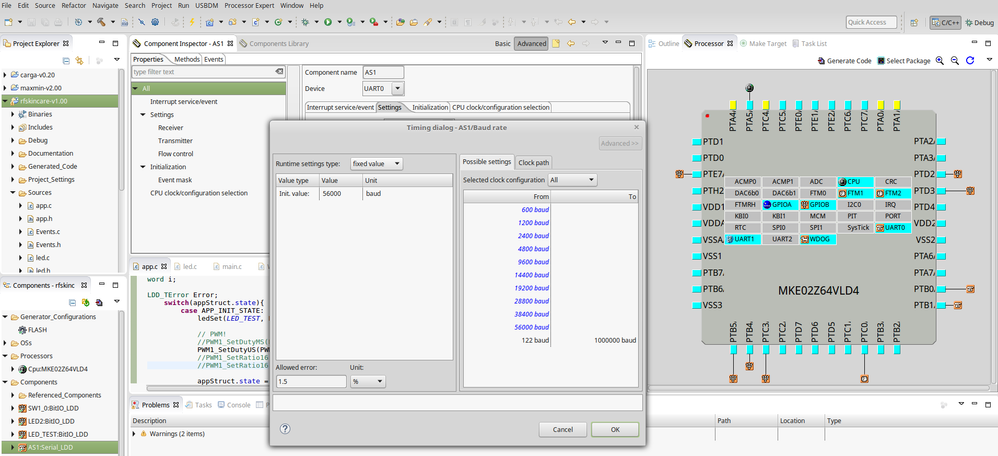

I'm trying to set the UART at 115200 bps using the Asynchronous serial communication PE component with no success. Here's the available list shown by the Component inspector (max 56000 bps)
The KE02Z device is running at max (I think) ICS clock of 32MHz and the bus clock at 16MHz.
I need to set the UART at 115200 bps. How can I do it?
regards,
gaston

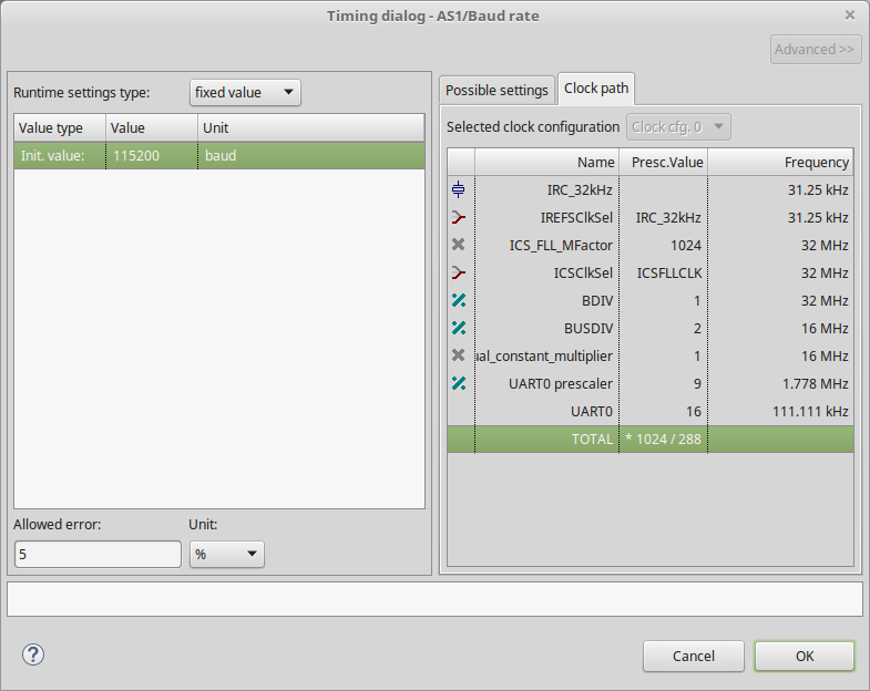

marek-trmac
Hi Gaston,
here is how you can easily review possible timing for the peripheral:
- open timing dialog
- type required value, e.g. 115200 into table on the left side
- if not possible to set desired value, increase "Allowed error" below (to 10-90%)
- after timing is set, open "Clock path" tab on the right side
- review clock propagation from the source to the peripheral
  and check what closest value is selected
Hope this helps

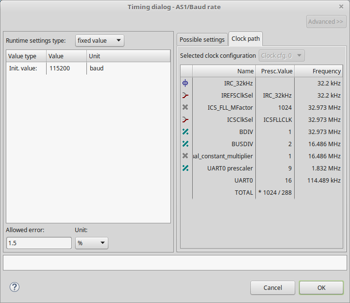

Hi Marek,
Yes, I did as you suggested but I'm not able to change the clock path. It is fixed as shown with the UART settings at 111.111 bps (above of recommended 1.5% precision)
Any hint to set the rate below 1.5% of the allowed error?
regards,
gaston

gschelotto
Contributor V
Marek, great tip! I've managed to trim the RC oscillator to 32.2KHz in order to get the desired UART data rate
It's okay but..., what about the drift of IRC (due to temperature variations, settings accuracy,...)? I'm not able to find this information in the KE02 Sub-Family Data Sheet. Could you help me with this last question?
