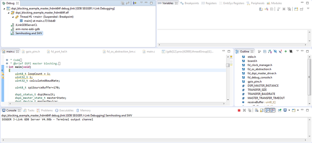

HI, when I debugged example program provided by KSDK1.2.0 -- "C:\Freescale\KSDK_1.2.0\examples\frdmk64f\driver_examples\dspi\dspi_blocking\master\kds" using KDS3.0, I wanted to see if any "printf" can be shown in the "Semihosting and SWV". However, nothing appeared in the console.
I have followed the instruction "How to use printf() to print string to Console and UART in KDS". But it didn't work.
I have no idea about it. Could you please help me?

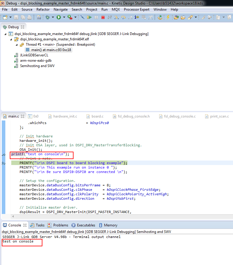

(1) As Erich said "KDS v2.0.0 and KDS v3.0.0 are using different libraries." , so if you want  shown in the "Semihosting and SWV".  , please configure like this :
(I test also on the demo you mentioned )
then on the code ,please use "printf();" , then run the code , you will see as this :

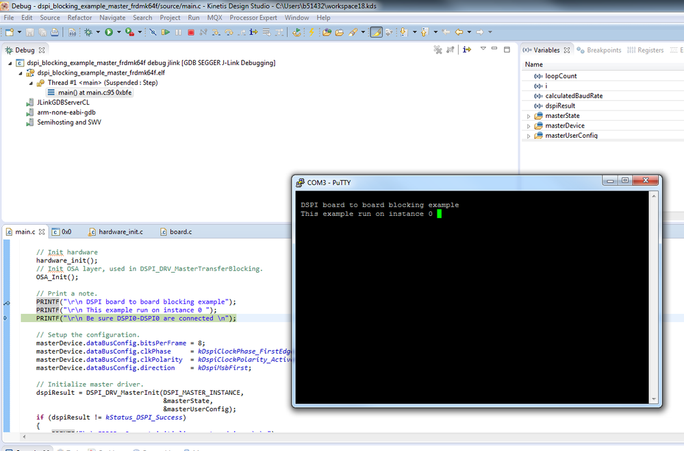

(2) About the demo project , the function of " PRINTF()" will show on the terminal :
Please have a try .

And the attachment is a simple project i create on KDS 3.0 , ksdk 1.2 , and please try on your side , check whether it can print to console view.

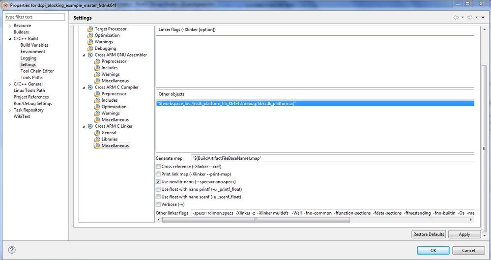

The linker option -specs=nosys.specs need to be changed to specify
-specs=rdimon.specs
Semihosting Enabled in KDS v3.0.0
If still this still can not work , please tell me !

I have paid attention on the linker option: -specs=rdimon.specs
However, it still doesn't work.

(1) Oh, :smileysad:    please  show me the code you use to print to console ,
for example on my project , i use  pirntf("test on console \n");  what about yours .
(2)  Have you test on the project i send  to you , and configure only have the  "-specs=rdimon.specs"  like this :
