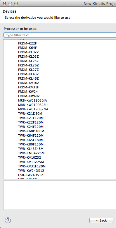

     List of supported boards after integrating KSDK-1.3 into the KDS.

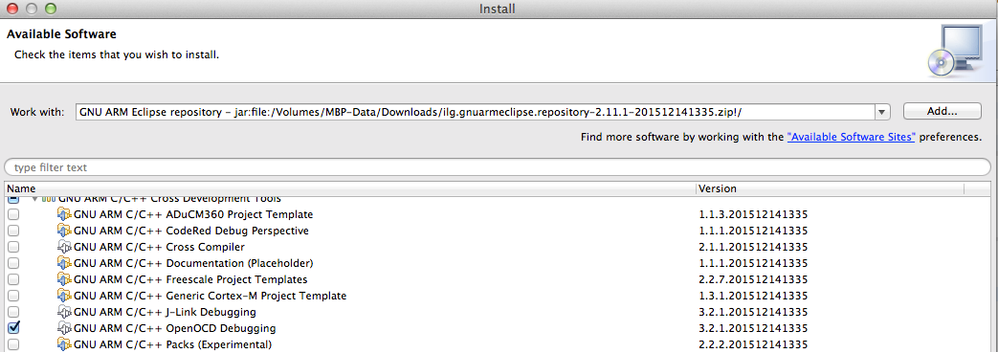

  • Add eclipse support for OpenOCD Debug.
          Download the file and install the plugin (Help->Install New software->Add->Arhive) ilg.gnuarmeclipse.repository-2.11.1-201512141335.zip
          Seclect the OpenOCD Debug and others if you want.

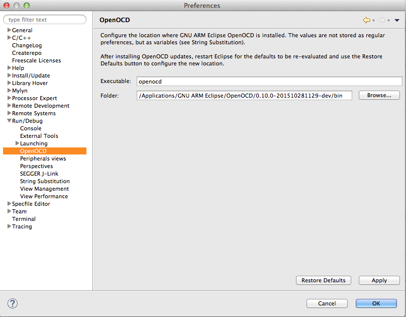

          after install you need to set the correct path for the openocd binaries.
          Go to the Kninetis Design Studio -> Preferences menu and set the path.

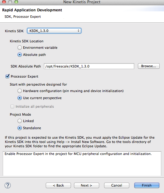

    • Start a new project as NEW->Kinetis SDK 1.x Project
    • Choose a name
    • Choose a Board or processor
    • Select the Kinetis SDK with ABSOLUTE PATH and add PE support
      • (of course you need to set your own installation path)

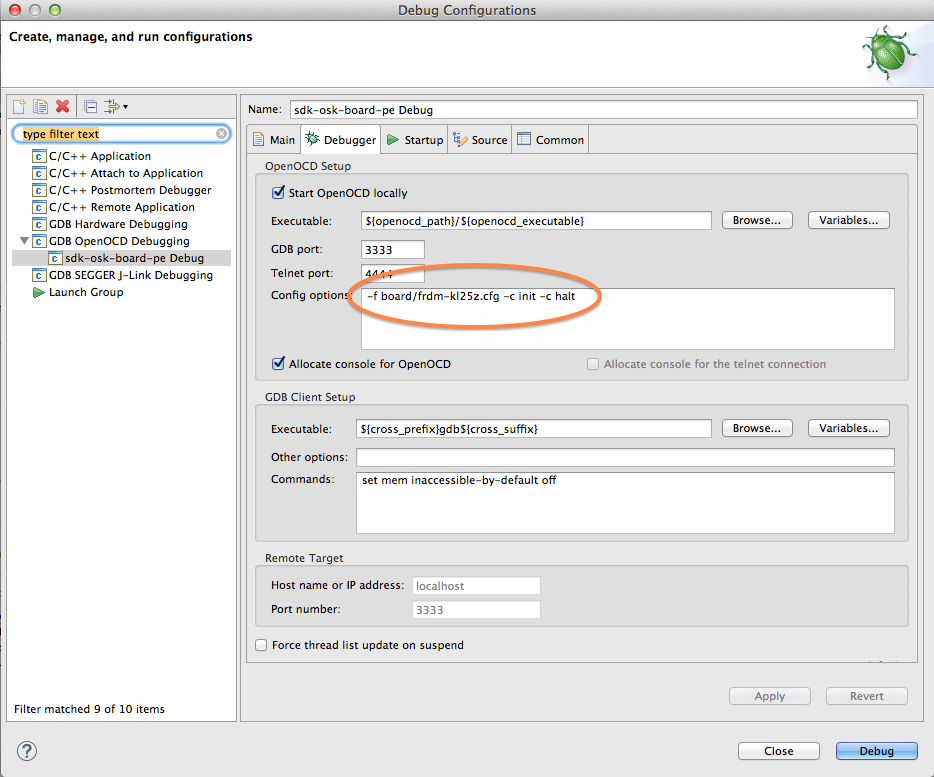

      • After Finish make a new debug configuration in your project's settings as follows

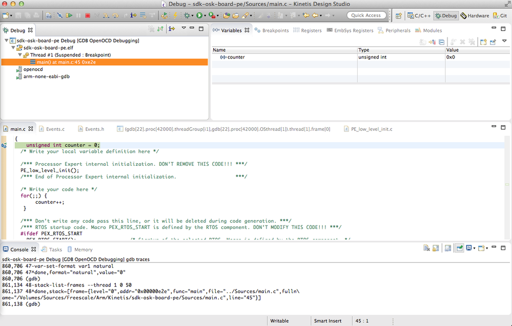

And... Finally get working
