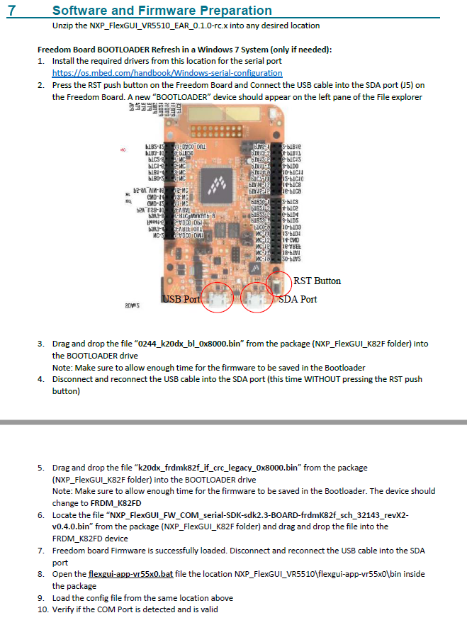

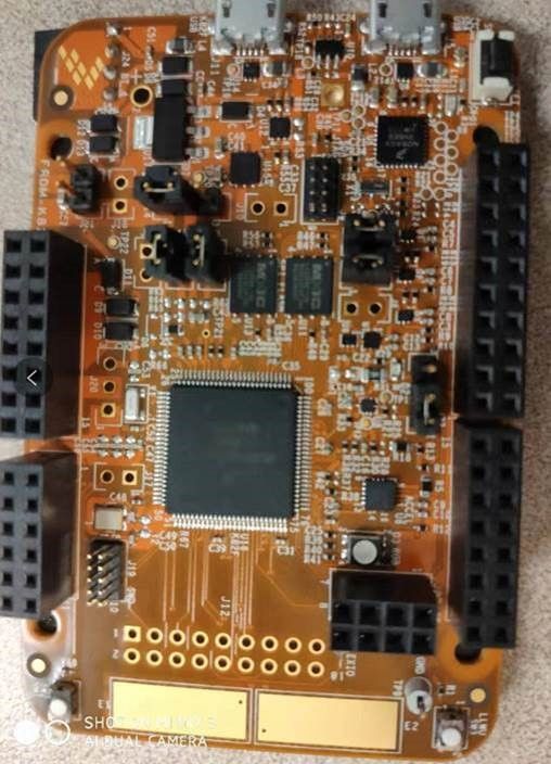

Hello Team
I  used Win10   to  update the program of K82F board(as below plot) via OpenSDA following one  document as attached. I should use Win7, but I did 't  pay attention  to this info.
Now , the board can not be  recognized by computer when I re-connect the OpenSDA USB to the PC.
Do you know how can I  update the program under this situation.
Thanks very much for your support in advance.
3,147 Views
jingpan
Hi Cindy,
Please check the solution in OpenSDA Serial and Debug Adapter | NXP
https://community.nxp.com/docs/DOC-330935
Jing
