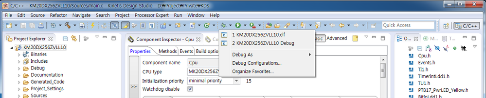

I'd like to use the Kinetis Design Studio to develop for Kinetis Processor.
I installed KDS 1.0.1(beta), and try to connect target.
But I face with Error Window when i click debug Icon.
The window title is "Unable to Launch", and content is "The selection cannot be launched, and there are no recent launches."
Could you help me to use KDS ?
At this time, Build is OK, no error.

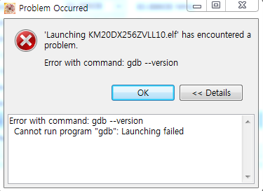

youngcheolsong
Thank you Erich,
I installed KDS V1.1.0  and try to development my project.
Build is OK, but when i click the Debug ICON another Error Window as below.
Could you help me what can i solve this problem ?
5,710 Views
BlackNight
That's a Eclipse GDB general problem from what I can tell (happens for other Eclipse distributions too):
You need to select from the drop down list which debug configuration you want to launch:
If you just want to press on the 'debug' icon, you need to check that it lists the launch config you want in the tool-tip:
For the tooltip to show up, you need to have debugged that project before, and you need to have that project selected.
I know that this is not the easiest thing and a quirk of the current Eclipse CDT debug integration, and I hope this will be improved in the next Eclipse release.
Erich

youngcheolsong
Hello Erich,
Thank you for your help.
I can see only two items debug configuration from my drop down list as below.
When i select the -------.elf item the same problem window is popup.
But i select the ------.debug i can goto debug mode and run the target board.

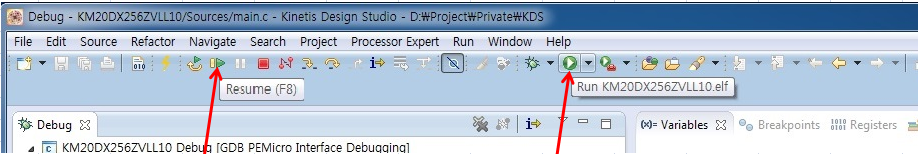

And i have another problem.
In the debug window, 'Resume' icon is OK.
But when i click the 'Run' icon i face with problem window as below.
Why i can't run the ------.elf.
Could you help me some more ??
5,711 Views
BlackNight
'Run' does not make any sense, as this is typically for running an application on your local host machine. What you want to do is debug, not run.
You can see this if you inspect the Run configuration: there is nothing where you can specify which debug connection to use, and because no debug connection is set up, it will fail.
