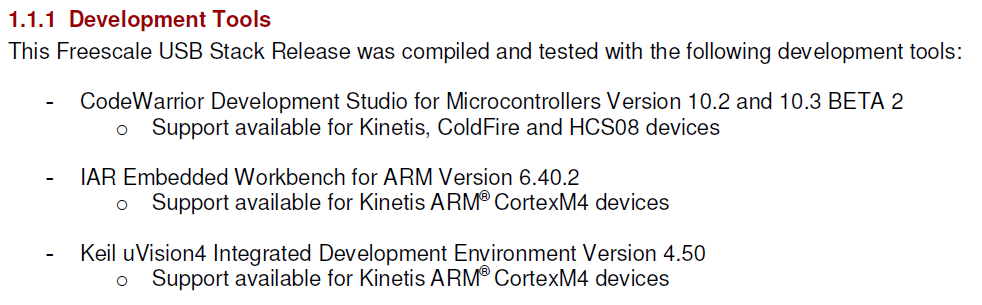

How do I download and  install USB CDC Class component  from USB stack 4.03 for KDS ProcessorExpert?
I NEED A CDC DEVICE FOR K20 BOARDS.
Where is USB stack 4.03?

Hi Koorosh Hajiani,
we can download USB Stack v4.0.3 from here:
USB Stack|NXP
however, usb stack v4.0.3 is a very old version, officially it was tested under Codewarrior 10,IAR, Keil only. see below developement tools requirement:
fortunately, Erich has article regarding use USB stack v4.1.1 processor expert with KDS. you could refer
USB CDC with the FRDM-K64F, finally! | MCU on Eclipse
I suggest you use KDS+KSDK processor expert to implement USB. refer these articles:
Creating a New USB project with KSDK and Processor Expert support in KDS
How to implement a USB Device MSD demo based on KSDK PEx components and KDS 3.0
Can this help you?
