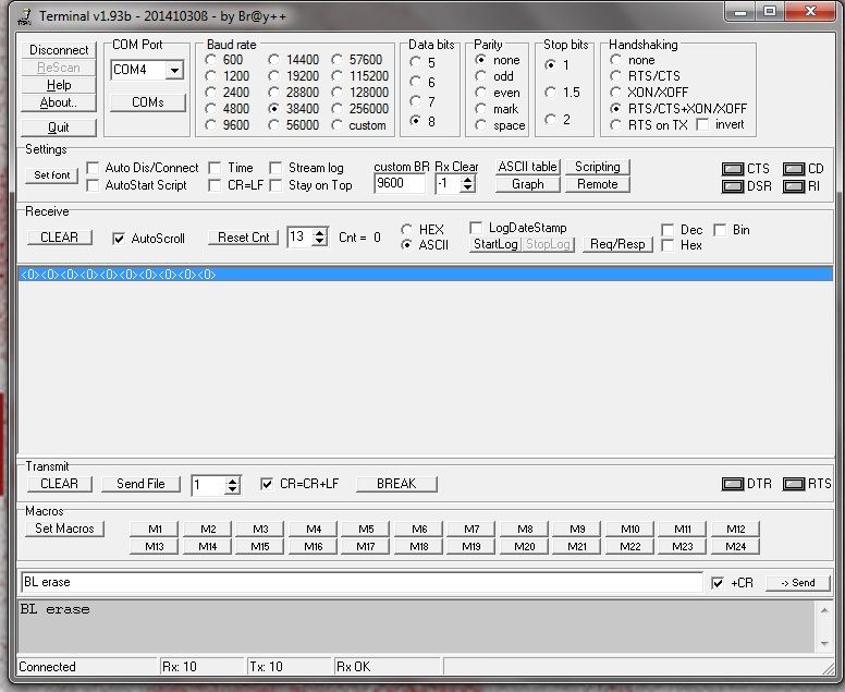

I am trying to design a boot loader for MKE02Z64VLD2 controller fitted to my customized board. I have configured a switch to be Boot Loader button, if the switch is turned ON, it will enter Boot loader mode. If the switch/button is in OFF state, it will erase the flash blocks and will wait for an application file to be loaded serially through a Terminal Application (Terminal). After fixing all the errors which I faced while building the code, I tried to test it in my hardware. Before testing the code, I just tried to run a simple "LED Blinking code" which serves as my application code in the boot loader. It worked fine. The LED blinked. Then I flashed (using 'flash from file' option of KDS) the Boot loader code into my board. The most famous trace message popped up , "Semihosting process monitor job. java.lang.IllegalThreadStateException" . To verify that nothing had happened to my board, I again tried to debug that "LED Blinking code" in my board. This time it didn't blink and it threw some trace messages, which I have explained in my last part of this question.

I thought my code had flashed successfully into board. So I tried to load the application file via terminal application which I use. But it was unresponsive. When I sent an "Erase" command, the display should say " Erasing Flash blocks" instead the display said "<0><0><0><0><0><0>" .

Hello Ganesh,
What's the address does your application start ? 0x00? I think not .
While in your LED app linker file , the start address is 0x00 .
I think you have not know clearly the bootloader theory, i recommend you
read this doc carefully : Kinetis Bootloader to Update Multiple Devices in a Network - for Cortex-M0+
this article introduce the process of bootloader and how to writhe the APP clearly .
And about your Terminal , do you know what commond does it send , for example , which address does it
send to write APP code ?
Also when you erase , start which place ? Does it erased the bootloader code ?
In a word , i strongly recommend your read the DOC i mentioned , then  if still have any question , you can
contact us without any hesitate.
