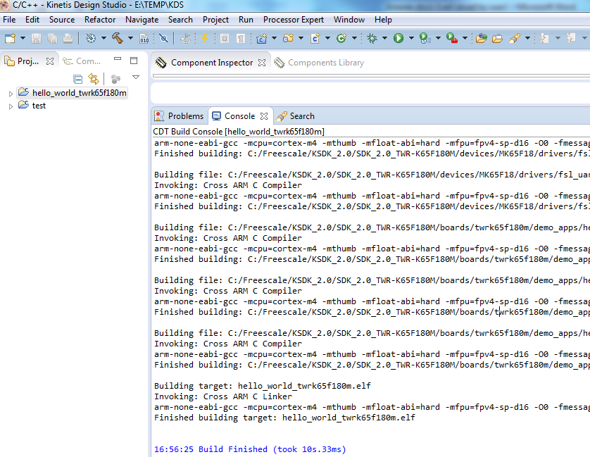

I tested in KDS3.2, and it builds the example project ‘hello_world’ successfully. Could you please:
1)  Update the KDS IDE from “Help” menu->Check for Updates. For details, please refer to section 5.2.1 in this doc:
..\SDK_2.0_TWR-K65F180M\docs\Getting Started with Kinetis SDK (KSDK) v.2.0.pdf
2) Import the example project from this subfolder ‘hello_world’ by following the instructions in section 5.3:
..\SDK_2.0_TWR-K65F180M\boards\twrk65f180m\demo_apps\hello_world
3) If the project is built with failure, please select ‘Project’ menu->Clean, then rebuild the project.
Does it work? If not, Could you please attach a screenshot to show the error message, and please also attach your project. Thanks!

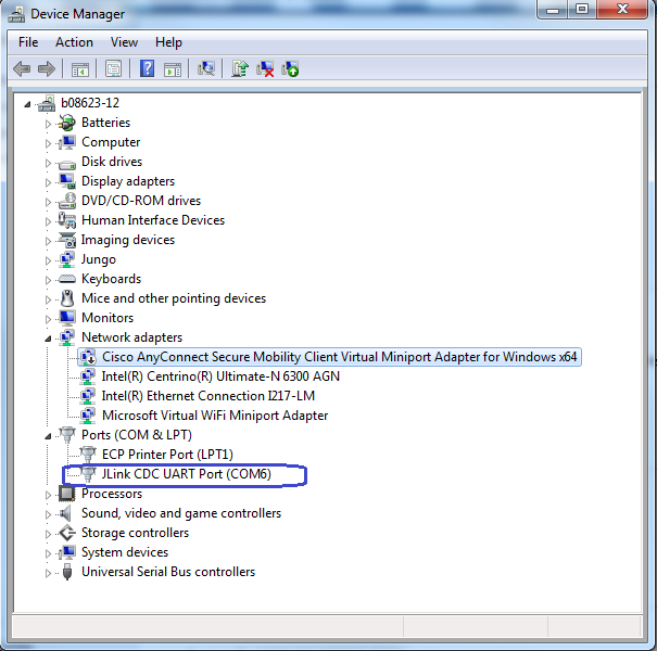

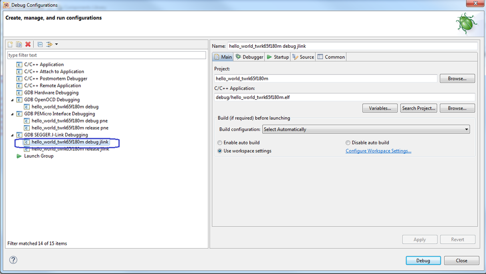

Whether the K20 works as Segger,PEMicro or CMSIS-DAP depends on the firmware in it.
Please connect TWR-K65F180M board by J7 with your PC, what is displaying in Device Manager?
On my side, it shows JLink CDC Uart, because the firmware pre-programmed in K20 is for Segger-Jlik.  And I choose Jlink for the connection.
Please check your device manager, and these links should be helpful to you:
https://community.freescale.com/docs/DOC-100705
https://community.freescale.com/docs/DOC-100720
https://community.freescale.com/message/529685#comment-529685
https://mcuoneclipse.com/2014/04/27/segger-j-link-firmware-for-opensdav2/
