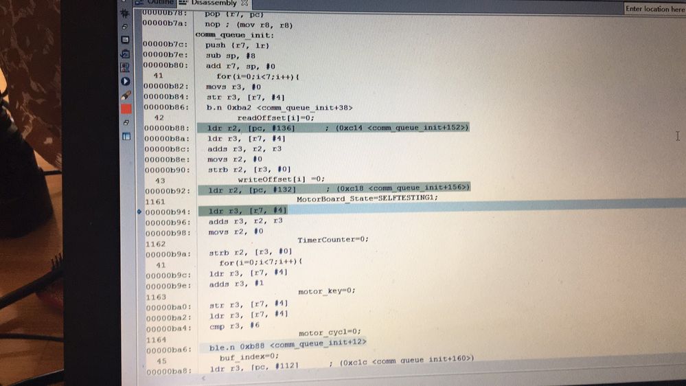

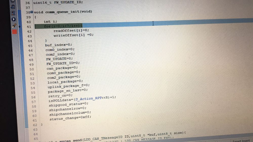

in source code ,it is a for cycle.but in the assembler,"MotorBoard_State=SELFTESTING1"insert.
I don't use OS,it is very strange.
Is this kds's bug?

The PC point jump at 1161 from 43.

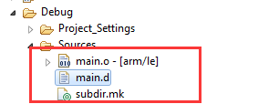

Please clean your project, also delete the file of intermediate files :
then rebuild to test again. If still have this error, pleas search where is the
code in your project, this is link to wrong place,  if you can't find it , please
share your project to me .
