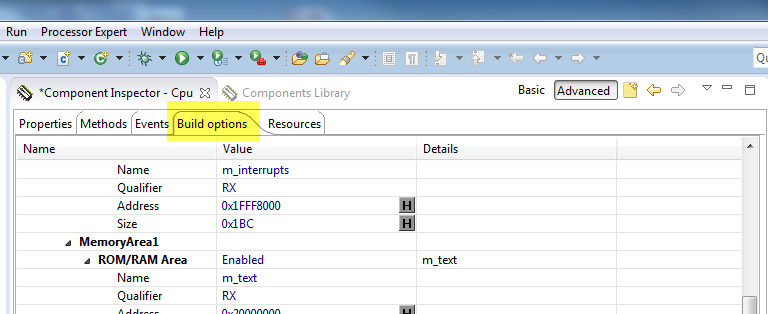

Hi Santosh.
understand. You mean Generator_Configurations feature of processor expert.
In processor expert Generator_Configurations, choose RAM or FLASH result corresponds with different memory allocation in "build options" , thus after generating code, processor expert will generates different linker file *.ld.
one of the most important function is memory allocation.
However if don't use processor expert, KDS itself doesn't have exact feature. (CodeWarrior 10 has this feature but KDS not)
If user wants it, user can manually create a RAM based ld file. ( usually the default ld file is FALSH based). then create a new configuration for RAM. then switch the build configuration as I suggested in my initial response.

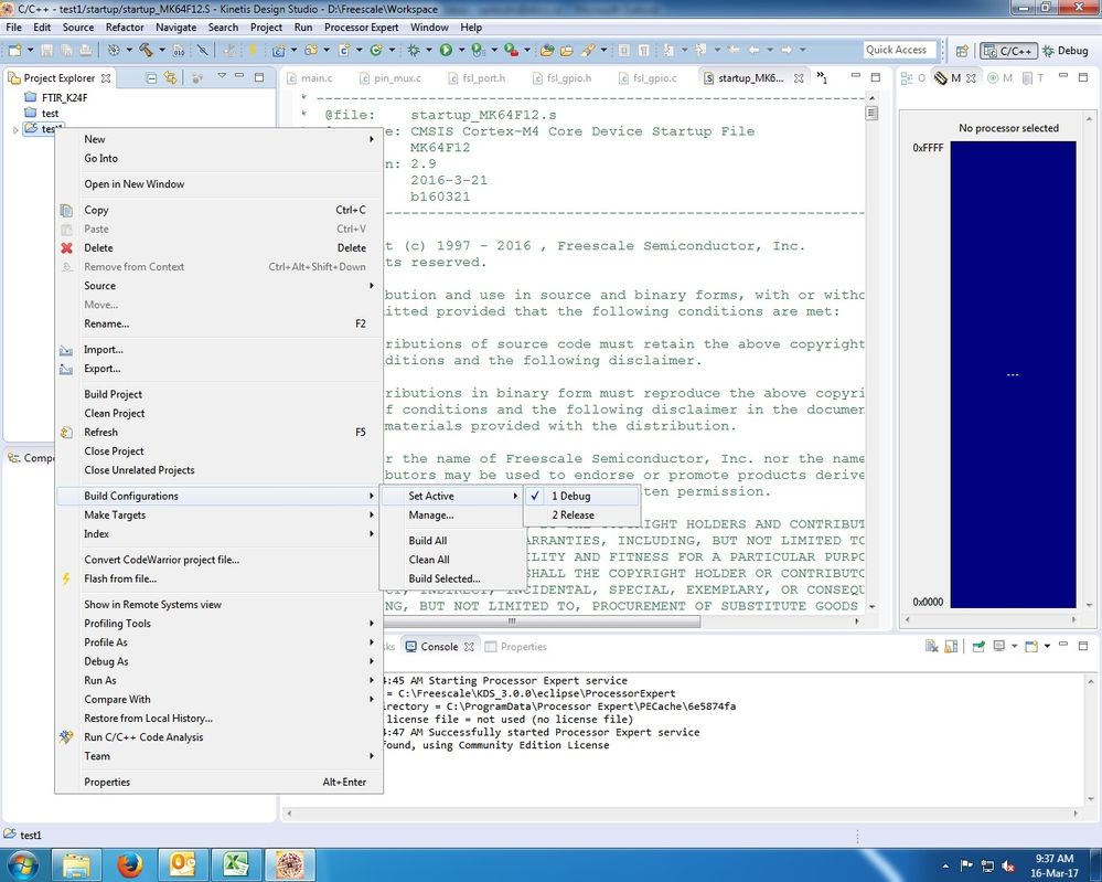

Thanks Jennie for responding to my question. Actually, you are saying how to change build configuration for a project i.e. either Debug or Release as indicated in the image below, right?

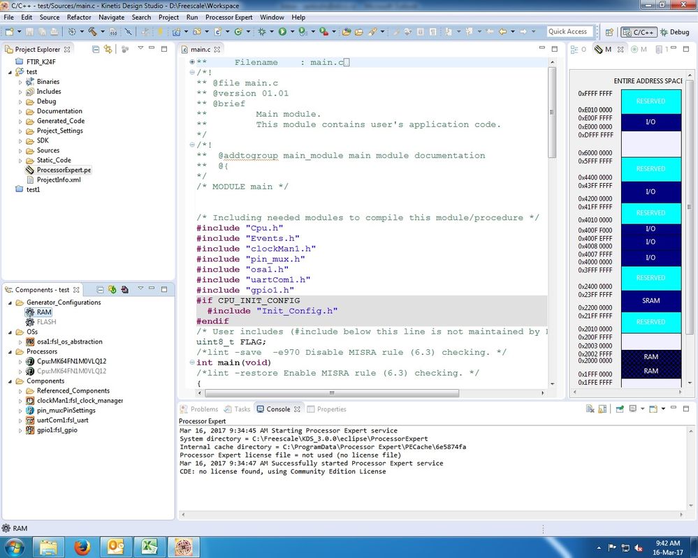

But, I want to change the target where I can load my code i.e. either RAM or FLASH. I can do this by using Processor Expert. The image below shows the same.
As you can see in the Components window under Generator_Configurations we can select RAM or FLASH target for the code to load. So, my question was can I do the same without using Processor Expert?

Hi Santosh.

ZhangJennie
Hi Santosh.
Normally if your project includes two configurations: RAM, FLASH. This two configurations are corresponding the different linker file.
To switch to the other configuration, we can right click on the project name in "Project Explore" window, then "Build Configurations", "set active..." to set the right configuration you want.
Hope this helps.
