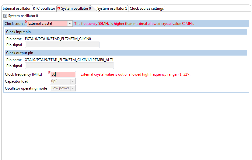

On TWR-K70 OSC0 is 50MHz. I can't set it in KDS. Any ideas?

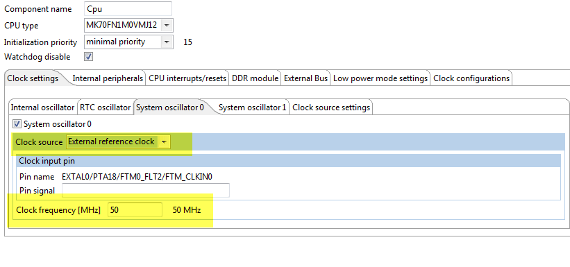

Hi Waqas Butt,
You select clock source as "crystal", however the maximal crystal value is 32Mhz.
you need select clock source as "External reference clock" which allows to set 50MHz clock frequency .
Jennie Zhang
