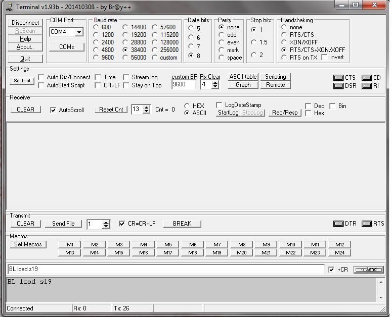

I thought my code had flashed successfully into board. So I tried to load the application file via terminal application which I use. But it was unresponsive. When I sent an "Erase" command, the display should say " Erasing Flash blocks" instead the display said "<0><0><0><0><0><0>" .

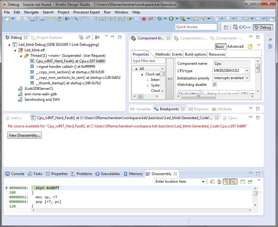

To verify that nothing had happened to my board, I again tried to debug that "LED Blinking code" in my board. This time it threw the same trace messages which I fixed earlier.
These are those Trace messages.

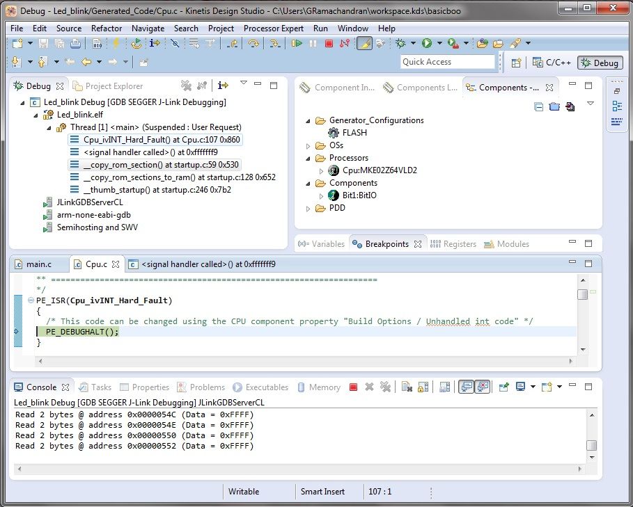

To resolve this PE_DEBUGHALT problem, I searched the Internet and found this. https://mcuoneclipse.com/2012/02/20/oh-my-an-interrupt/
This is how it looks inside vectors.c.

And this is how my KDS screen looked when I pressed the debug button.
Now how to find out which Interrupt is causing the problem from both the figures and how to fix it ?

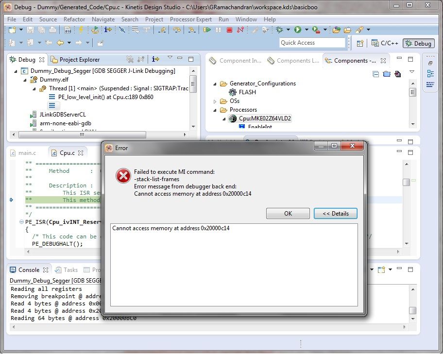

I even tried to debug a dummy project with nothing written inside main.c. Still I cannot successfully debug. This is how my screen looks when I tried to debug an empty project.
148615_148615.jpgNXP dummy1.jpgo
