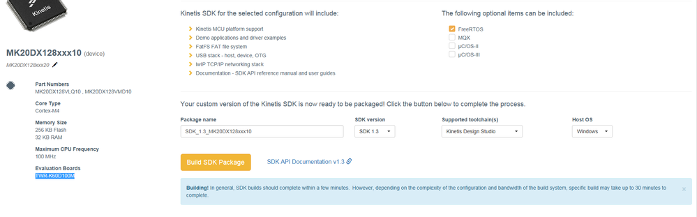

We're getting the TWR-K20D50M development board in couple of days, I'm currently working with TWR-K64F120M and have setup the design studio and build debug ,flash using the SDK1.3.0.However I could not find any projects based on the TWR-K20D50M board in there.
Is there any KDS demo or projects that support TWR-K20D50M board?

I tried your suggestion and installed KSDK 2.0 as indicated by the link in your response , the summary sheet is shown below:Capture_summary.PNG
As you can see the device and part numbers are correct however the EVAL BOARD is shown to be TWR-K60D100M which is a populated with a different device .
WHY IS THE PART NUMBER MK20X BUT THE BOARD COMES UP WITH A DIFFERENT TARGET(K60 SERIES). I JUST CHOSE THE PART NUMBER AND THE EVAL BOARD CAME UP WITHOUT ME CHOOSING IT.
IS THIS DEMO WORKS ON A TWR-K20D50M BOARD?
I'M CONFUSED.AM I MISSING SOMETHING?

Sorry Koorosh,
I made a mistake, the part number of the board TWR-K20D50 is K20DX128VLH5 , not the pastedImage_0.png.
So, as so far , no matter the KSDK1.3 or KSDK 2.0 all not support the chip , sorry !

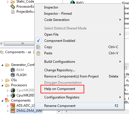

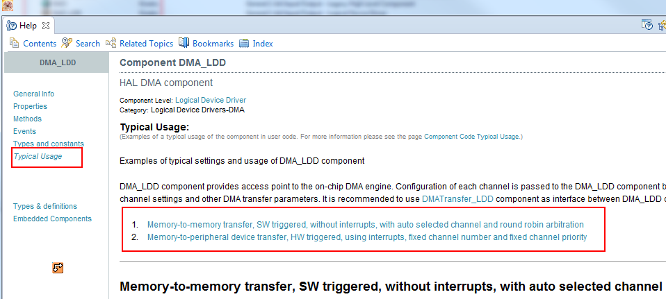

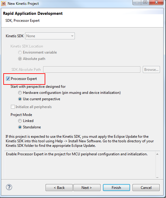

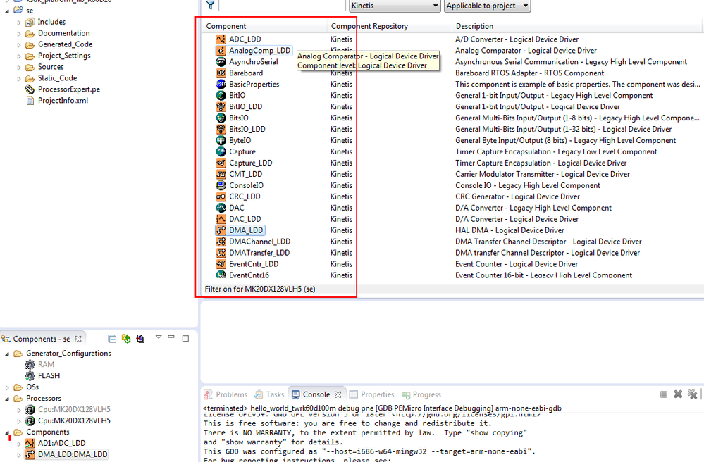

And now , you can use the PE on KDS , after create project,  you can add Processor Expert to the project , then configure ,
then it can generate code automatic.
About each component , there also have the example under the "help on component", for example the ''DMA_LDD" :
Hope it helps
Alice
