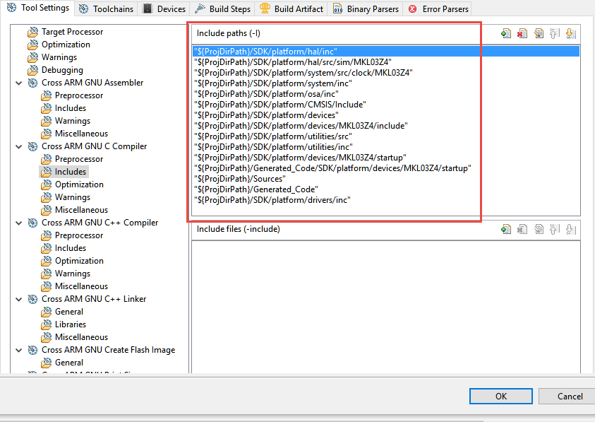

As long as you are not using absolute paths in your project settings, then you easily can share them with a version control system. Use variables like ${ProjDirPath}:

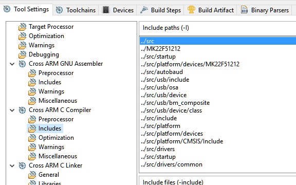

Even better, use relative paths like this:
For the above, you need to know (or keep in mind) that the 'current directory' for the build tools is the 'output' folder in the project (usually 'Debug' or 'Release'). So '../' goes up one level. That way the paths are relative to that folder.
