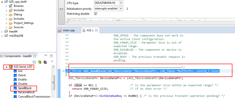

Hello Steven,
(1) Do you want a UART function that send numbers of bytes ?
If yes, which IDE do you use , if you use KDS, you can create e PE project , then utilize the function of
"LDD_TError AS1_SendBlock(LDD_TDeviceData *DeviceDataPtr, LDD_TData *BufferPtr, uint16_t Size)"
the "Size" is the number of bytes.
(2) "I looked at the UART code" , which code ?
Alice

stevencornett
I just noticed that you are using the Serial_LDD code package.  I derived my UART code from the AsynchroSerial package.
Is the SendBlock implementation going to be slower than the one derived from the Serial_LDD?  If so, would it then behoove me to refactor my top level to use routines derived from Serial_LDD?

Hello Steven,
(1) "AS1_SendBlock" and the "AS1_SendBlock" are the same .
(2)Sorry i can not know your problem clearly.  Could you pleas tell me how can i repeat your situation ? Especially repeat "resulting in a transfer time of 1.05ms instead of > 2ms?" thank !
About "have the effect of creating a delay between character writes" ,i have checked the code , there have not intended delay, the delay is the necessary configuration .
Alice

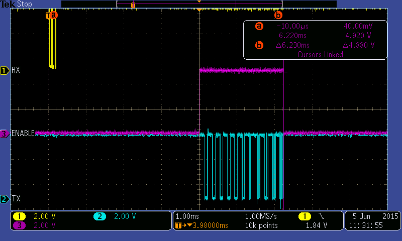

stevencornett
Here is a scope trace showing the issue.
The bottom trace (Channel 2) is the packet put out on the UART TX line.  If the byte-to-byte spacing is the way it ought to be, it should take up a little more than one major division of the scope, or 1ms.  It's taking up two milliseconds, or two divisions.
When you run a packet through SendBlock in Serial_LDD, what are you seeing?

stevencornett
When nothing intervenes between the characters, then the transfer time is reasonably close.
However, the library I was using incorporates a EnterCritical() function just before the transmission of each character.  That adds about 109 microseconds per character send; for 11 bytes that adds more than a millisecond to the transfer time.  Once I put the EnterCritical and ExitCritical functions outside of the loop, that fixed the problem.
I figured I should make mention of what the solution finally turned out to be.
