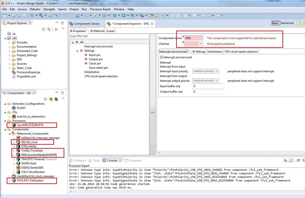

I'm trying to create a datalogger application using a custom layout based on the Kinetis MKL27Z256VFT4 and the FAT file system PEx component.
After selecting SD card and the other components, the SPI PEx component isn't supported with this processor, where is the problem ???

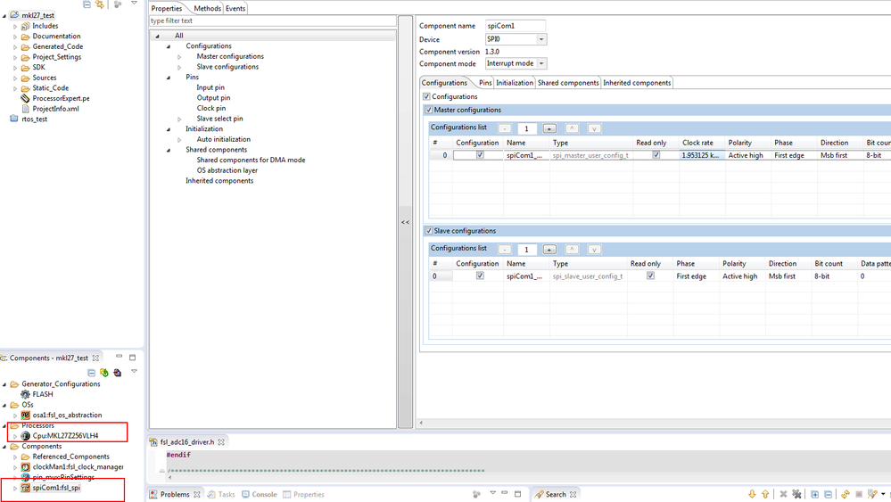

Hello Gianluca,
Could you please take a screenshot about why do you think it doesn't support the SPI.
On my side,  i create one project, then can add the SPI component :
Hope it helps
Alice

joe_dimaggio
Hello Alice,
sorry for the late reply, I worked on another project last days.
As you can see several processor experts components don't work with this processor: SPI, Timer, SD-Card...
The main component I need is FAT_FileSystem (with SD_Card), but this is not included in the KSDK 1.3.0.

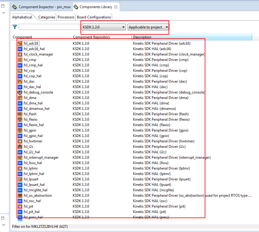

Hello Gianluca,
If your project is KSDK project,  you can not use the PE component without KSDK,
only can use the KSDK PE component :
there is the SD card component :
