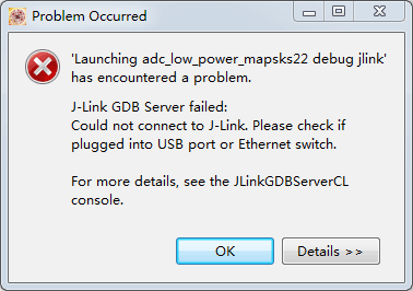

Hello, i'm taking test on MAPS-KS22F256 in KDS (Windows 7), using usb connect with computer and board. when debug j-link, there is a fault point to  connect method via IP
你好,我在调试MAPS-KS22F256时,通过USB与电脑连接,Windows系统下,KDS环境下,Debug时遇到报错,提示通过IP进行连接,但系统通过USB实现(J-Link)

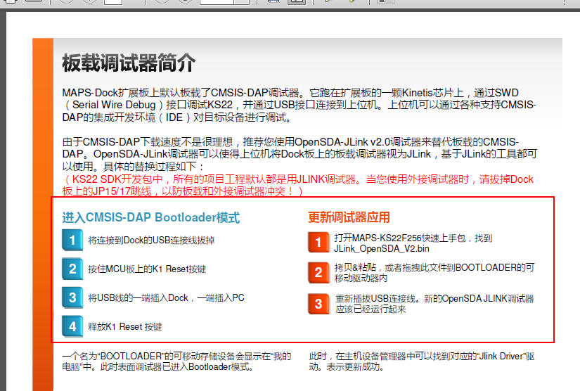

Hello Jack,
Please first update the debug interface on bootloader mode :
If still can not connect , please show your steps .
Hope it helps!
Alice

jackxu
Hi Alice,
After following your instruction, can be connected now!
Jack
