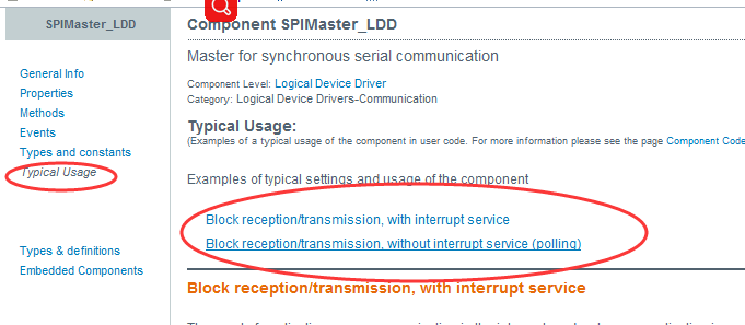

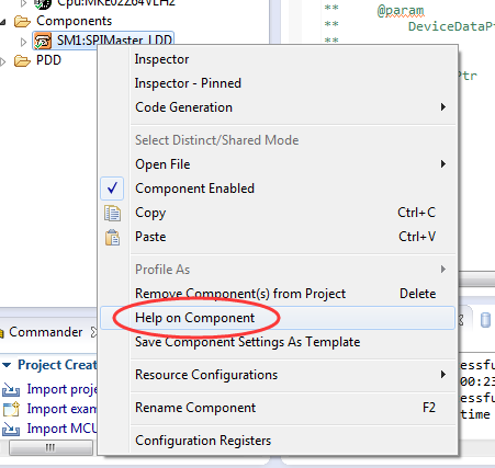

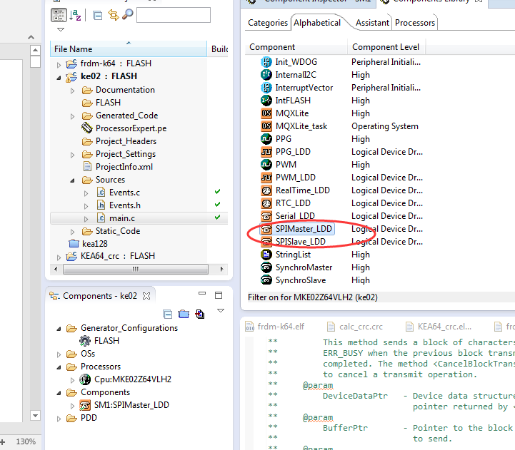

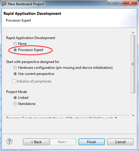

Hello Huy Nguyen ,
I recommend you first run a demo code on your board, check whether it can work well, then compare the code.
For example , there is some example: create a Processor Expert project on CW, then add SPI component, choose
"Typical Usage" under "Help on component ":
Hope it helps
