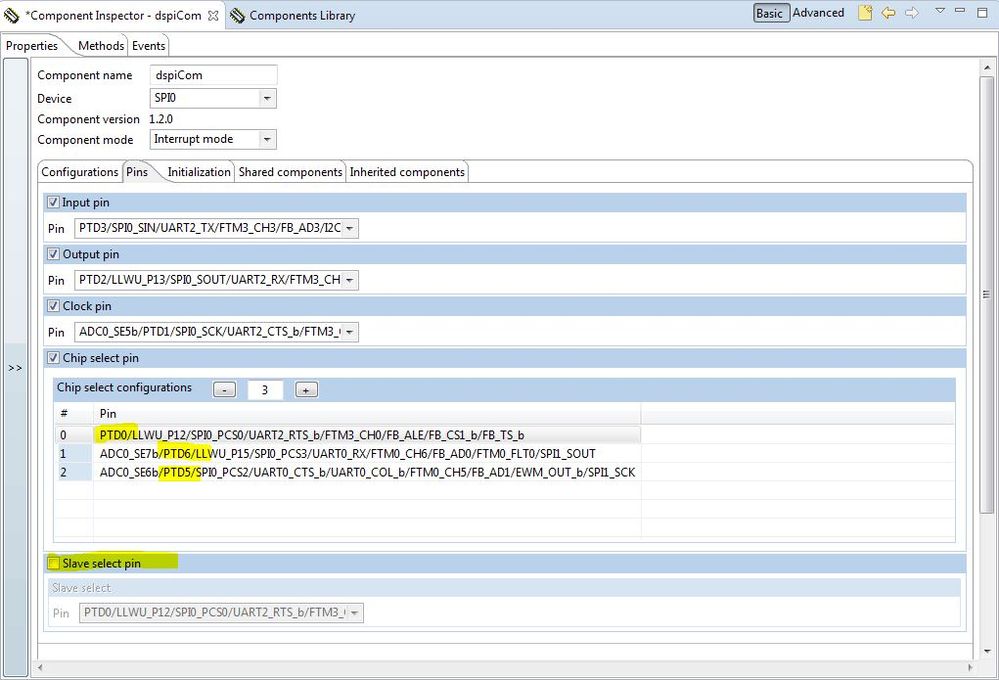

I have an SPI master(K64) configured with below settings. Currently, I am able to communicate only with one of the slave connected on Chip select pin PTD6. I am not doing anything through code apart from setdelay between CS and Clock. So is there anything else which needs to be configured.
How does the HAL know which pin chip selects to, if its PTD5,6,0
In the HAL layer, all I could see was

Kewal
Alice,
I guess I am wrong, In the first screen shot attached I have selected the PCS0,1,2 however in the chip select configurations I have selected the SPI0_PCS0, 2 and 3. but not SPI0_PCS1.
My slaves devices are connected on SPI0_PCS0, SPI0_PC2, SPI0_PCS3 so I should be selecteding the Masterconfig with PCS0, PCS2, PCS3 right.
so by doing that and what you suggested doing an external init I am able to get a response from PCS2 and PCS3. but failed to get any response from PCS0 however, the PCS0 enable is going low. So is it that the MISO line is held low/ high impedance state by any other devices.

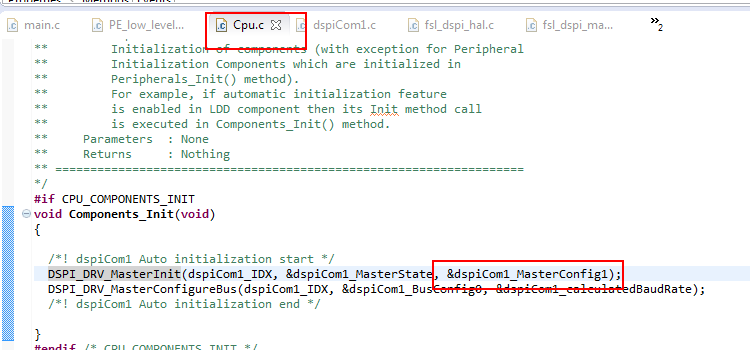

Hello Kewal,
Your configuration is right.
- And about which chip select to , after we configured the "chip select ", we can see the generate code on the file of"dspiCom1.c",
not on the HAL file .
- The reason why only one slave spi work is that, in the Auto  initialization  code ,it can only select one of them to initialize.
so  when you want select the other two slave SPI ,you can initialize them by hand refer to   the code under "comopnents_init".
or i think you can also use this function :
  DSPI_HAL_SetPcsPolarityMode(base, userConfig->whichPcs, userConfig->pcsPolarity);

Hello Kewal,
I think you should first be sure whether the slave0 (connected to the PCS0) send reply.
From your screenshot we can see the M0SI work well , while the MISO have no data ,
so maybe the slave do not work well .
Alice
