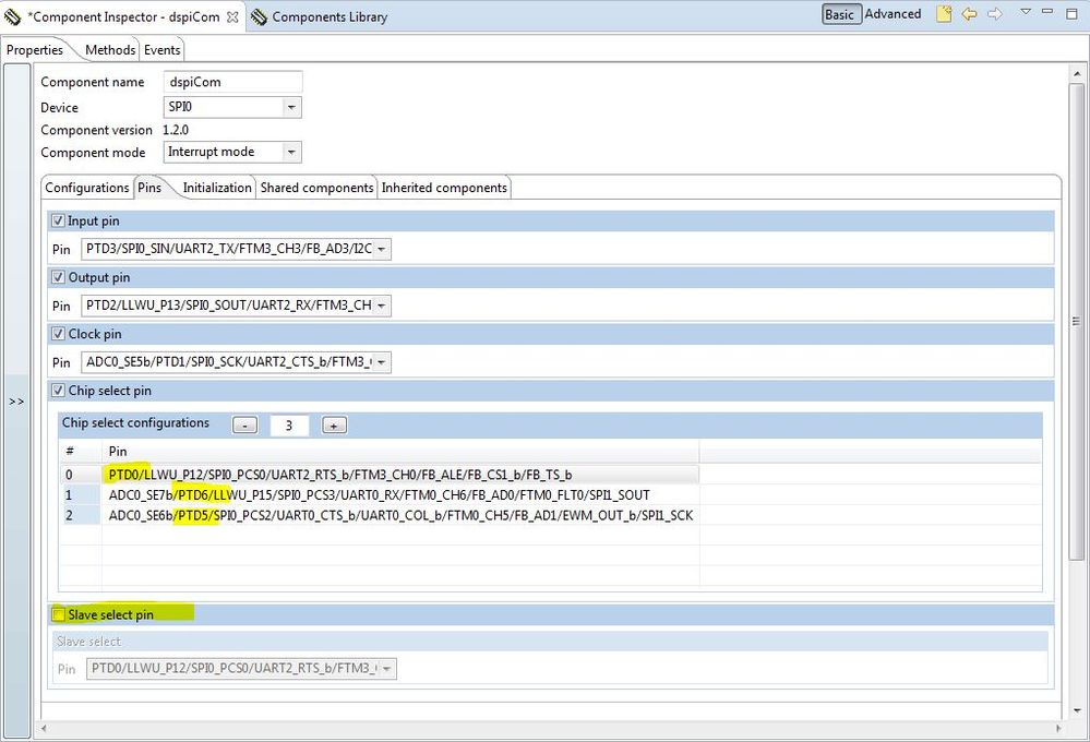

I have an SPI master(K64) configured with below settings. Currently, I am able to communicate only with one of the slave connected on Chip select pin PTD6. I am not doing anything through code apart from setdelay between CS and Clock. So is there anything else which needs to be configured.

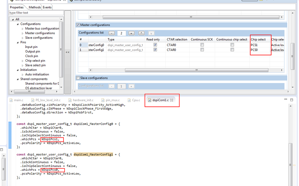

How does the HAL know which pin chip selects to, if its PTD5,6,0
In the HAL layer, all I could see was
/*! @brief DSPI Peripheral Chip Select (PCS) configuration (which PCS to configure)*/
typedef enum _dspi_which_pcs_config {
    kDspiPcs0 = 1 << 0, /*!< PCS[0] @internal gui name="PCS0" */
    kDspiPcs1 = 1 << 1, /*!< PCS[1] @internal gui name="PCS1" */
    kDspiPcs2 = 1 << 2, /*!< PCS[2] @internal gui name="PCS2" */
    kDspiPcs3 = 1 << 3, /*!< PCS[3] @internal gui name="PCS3" */
    kDspiPcs4 = 1 << 4, /*!< PCS[4] @internal gui name="PCS4" */
    kDspiPcs5 = 1 << 5  /*!< PCS[5] @internal gui name="PCS5" */
} dspi_which_pcs_config_t;
I think its a potential bug here in KDS.

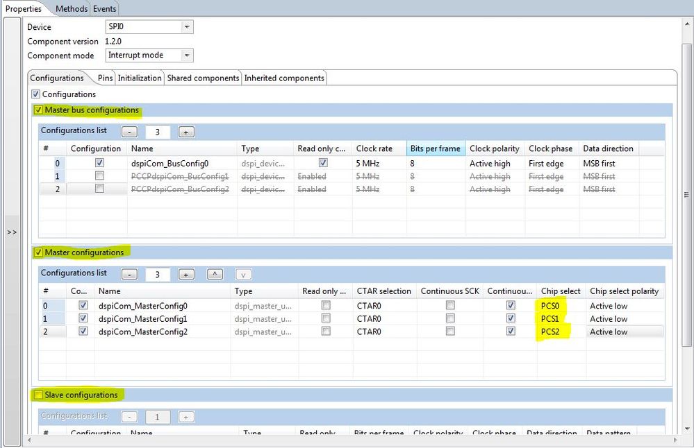

Hello Kewal,
Your configuration is right.
- And about which chip select to , after we configured the "chip select ", we can see the generate code on the file of"dspiCom1.c",
not on the HAL file .
- The reason why only one slave spi work is that, in the Auto  initialization  code ,it can only select one of them to initialize.
so  when you want select the other two slave SPI ,you can initialize them by hand refer to   the code under "comopnents_init".
or i think you can also use this function :
  DSPI_HAL_SetPcsPolarityMode(base, userConfig->whichPcs, userConfig->pcsPolarity);
Hope it helps

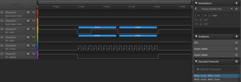

4,566 Views
Hello Kewal,
I think you should first be sure whether the slave0 (connected to the PCS0) send reply.
From your screenshot we can see the M0SI work well , while the MISO have no data ,
so maybe the slave do not work well .
Alice
4,566 Views
Kewal
Alice,
I have got it working now and the reason was the reset pin on the slave was tied to low,..  :smileysad:
