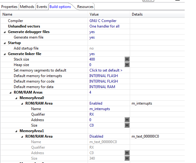

Hi everyone,
I want to build a bootloader program for MKE06Z128 using processor expert (Codewarrior 10.7). It uses UART for communication and  a terminal program(I don't wanna use Kboot or AN2295SW).I follow this post (Serial Bootloader for the Freedom Board with Processor Expert | MCU on Eclipse ) from Mr Erich Styger. But I have faced a  problem at the step to determine running bootloader or not. In this step BL_CheckForUserApp() has to be added in the cpu processor expert component to run before main()
User Code before PE initialization
But MKE06 cpu processor expert does not have user initialization properties so I don't know how I have to do this step.
My question is:
Where can I put BL_CheckForUserApp() to figure out bootloader or application program should be run?
or How can I create a bootloader program with processor expert for mke06?
Thank in advance.

Hello Thao Phan  ,
You can add the function BL_CheckForUserApp() into your project source code manually.
Alice

thaophan
Hello Alice_Yang
Thank you for you reply.
But i can't understand how it will work.
Did you do bootloader for MKE06 using PE before? Could you share your example?
Thao

thaophan
Hi Mark Butcher
Thank you for your reply.
I'll try it. But my application is built in CW10.7 and using Processor Expert. Does it matter if bootloader is built in another IDE?
Thao
