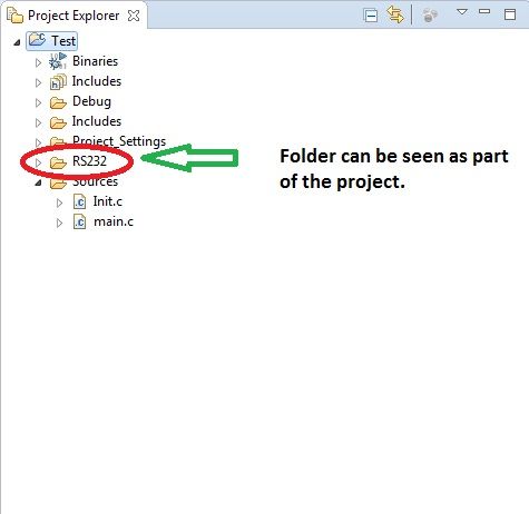

Hi Alice,
Thank you for the link.  The tutorial goes through what they call linking of the files and folders, but ultimately
the file/folder/functions appear in the the project itself.  Its like dragging the file/folders/functions into the project.
I don't know if its possible, but I was looking to actually linking a path where my repository is and linking one,
two, three, etc... items in the repository without to actually drag them in the project itself.
Something like this:
Then be able to address the members inside of the RS232.
The example above is different from this:
This is following the tutorial method which does work.
Like I said, I don't know if this is possible?
Neil

Hello Neil,
-Maybe you can make a lib about your repository, then add the lib .
-And about the link files, it is not copy and past into project,  all of your team members
can use it , they just link to the file of repository, if the file in repository changed ,
the member's also changed . The folder under project just a virtual .
Hope it helps
