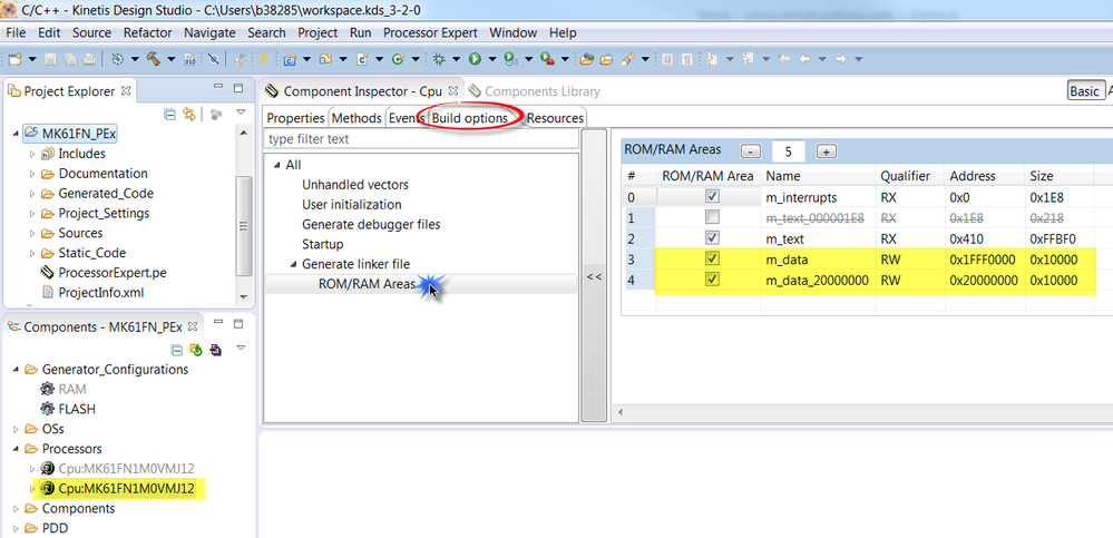

I am using MK61FN1M0CAA12R. I see MK61FN1M0VMJ12 CPU closer to this variant of K61 in Kinetis IDE and when I choose this for my project, I see that I have only 32KB RAM available.
Whereas, from datasheet I see that MK61FN1M0CAA12R supports upto 128KB RAM.
Can someone tell me what is the RAM size of MK61FN1M0CAA12R and how to configure it in Processor expert?
2,641 Views
Carlos_Mendoza
Hi Abi,
The MK61FN1M0CAA12R part has 128 KB RAM, you can modify the ram size on the CPU component ROM/RAM areas section:
Hope it helps!

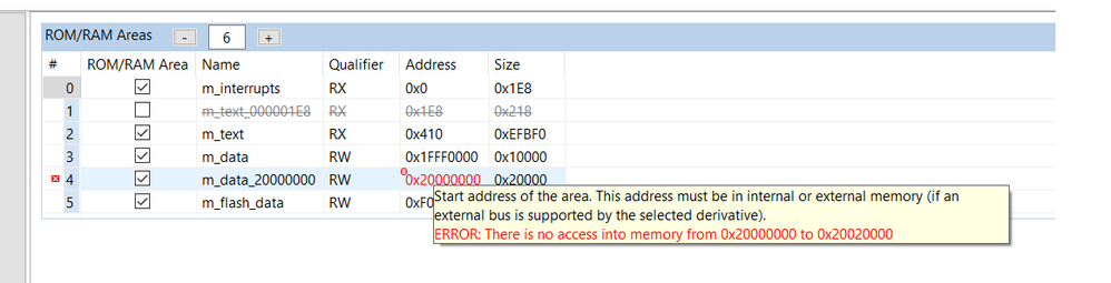

abiabi
Hi Carlos,
I tried doing the same but getting the following error:
Can you please let me know if I am missing something?
2,641 Views
Carlos_Mendoza
Hi Abi,
The default memory size of the project is correct, it is setting 128 KB of RAM (two regions with size of 0x10000)
Hope it helps!
