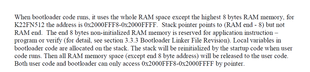

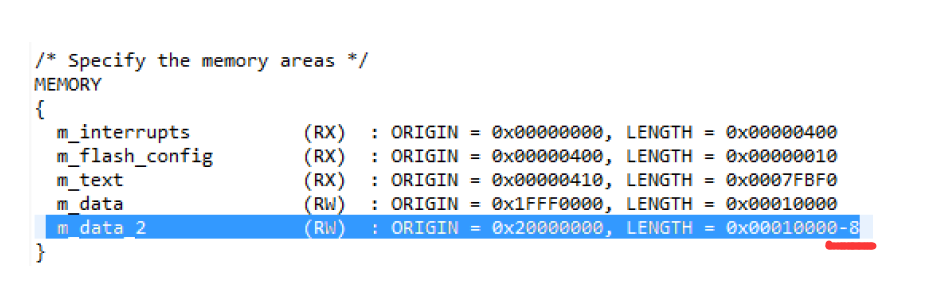

Hello Roy,
1.  Please pay attention when run the startup code the RAM memory will be initialized.
Except reserved without definition in the linker file .
For example use 0x20000000 to 0x2000FFF8 to save  the flag "appflag", we  can do not
includes this memory :
For I don't know your project flow ,so I'm not sure you have this question, if yes, you can refer
