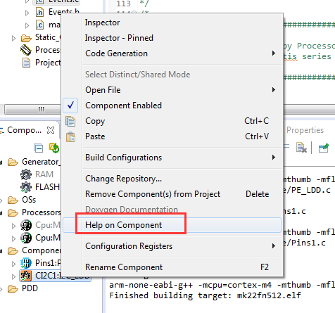

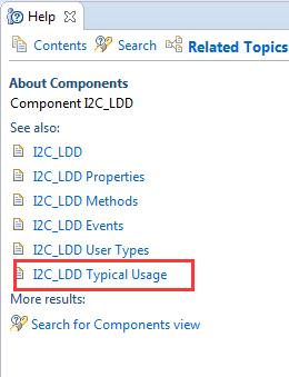

Hello Jace,
The "printf" shouldn't impact the project .
I recommend you first refer to the demo code under "Help on component ":
Hope it helps
Alice
