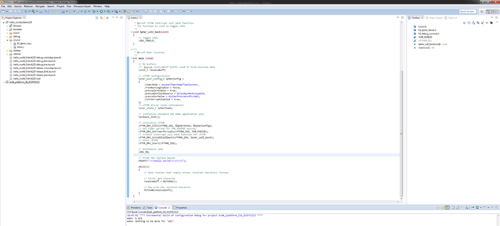

3,277 Views
jacewalton
Screen Shot of the console
3,277 Views

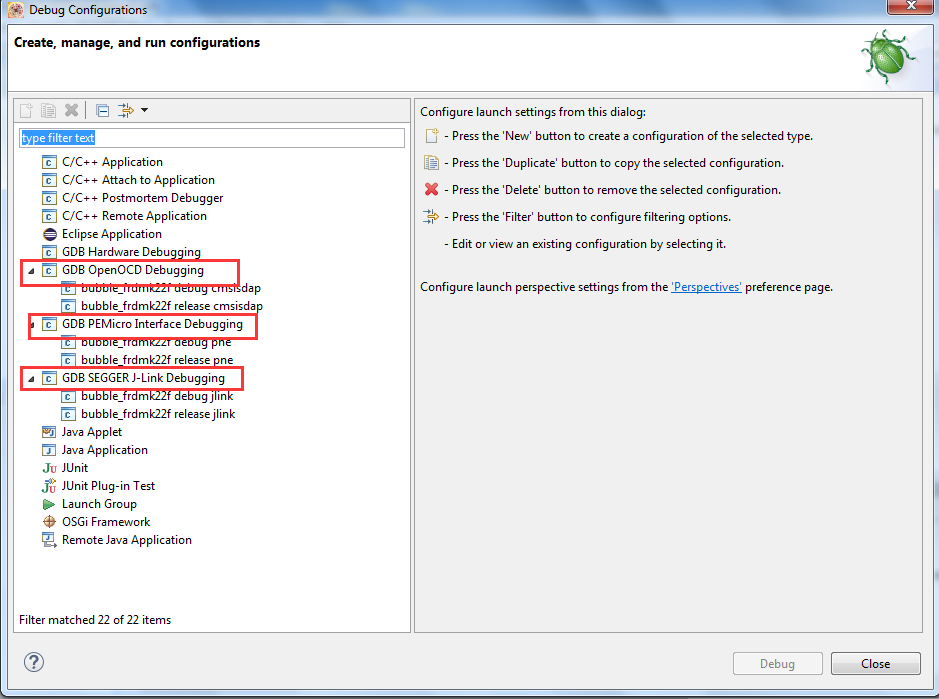

Hello Jace,
- About the debug mode , please check the Device Manager->Ports:
Then choose the corresponding debug mode on KDS:
- About the KSDKv1.3 and KSDK v2.0 , i recommend you use the latest version of KSDKv2.0 .
It easy to use , after you download it , just need import it into KDS, then build , download .
Using Kinetis Design Studio v3.x with Kinetis SDK v2.0
- From the console view, it seems you have not download project to your chip .
Please refer to the "Kinetis Design Studio V3.0.0- User's Guide Document Number: KDSUG ",
->  2.5 Debugging Projects
Alice

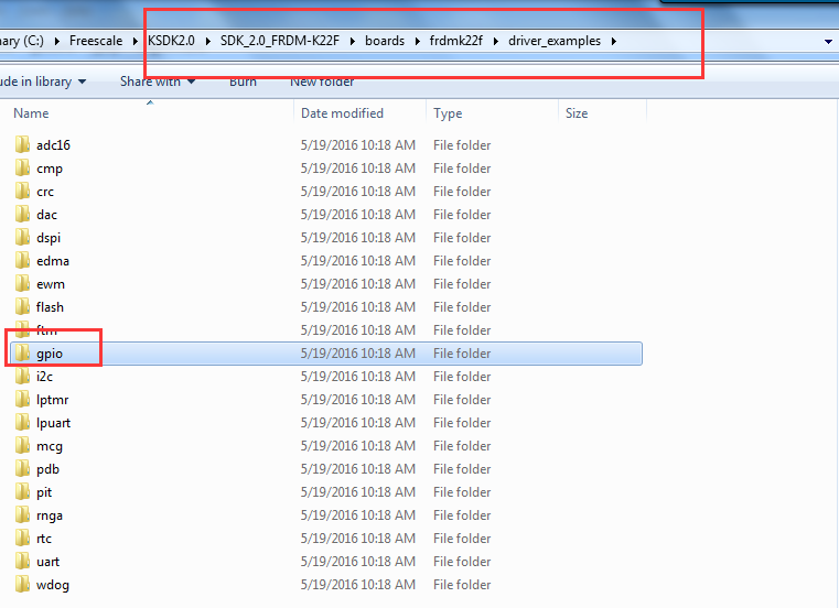

Thanks Alice, I got the SDK figure out but how do I control the digital ports.
Digital read and wright. as well as Analog Read.

Hi Jace,
There are gpio demo under KSDKv2.0, please refer to it :
Alice Yang
