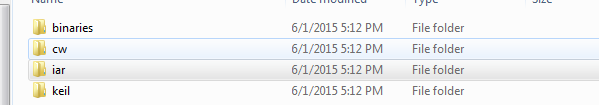

I installed Kinetis Design Studio and download Kinetis KE02-SC.zip examples.
After importing the projects in IDE, all projects appear with problems and the error "Program "make" not found in PATH".
Could you please help...
Thanks and regards.

Hello Jacques,
Does your KE02-SC example support KDS ?
In my hand ,it only support CW ,IAR and KEIL .
Hope it helps
Alice

Hi Jacques
The demo examples KE02-SC.zip are based on CodeWarrior, IAR and Keil. You may open or import the example project with any above IDE.
CodeWarrior v10.6.4 can be downloaded from:
http://www.freescale.com/webapp/sps/site/prod_summary.jsp?code=CW-MCU10
Or if you would import the project into KDS, please refer to this doc under your KDS folder:
C:\Freescale\KDS_3.0.0\doc\KDS_Porting_Guide.pdf

Hi Fiona,
Thanks to confirm what was mentioned earlier by other people above...
Anyway, as a suggestion this could help to enhance getting started manual by including starting from scratch procedures with KDS and available examples for this IDE if any...

Hello Alice,
Thanks for you reply.
Actually KE02-SC examples do not support KDS but these are the only available examples that can be found at KDS download web page...

Hi Jacques,
There is a CodeWarrior project converter in KDS:
It might not be able to convert anything, but should help you getting the project to KDS.
