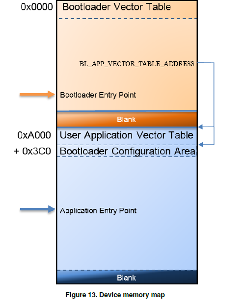

Dear Expert,
I need some description for  "Customize Boot loader" to upgrade firmware application on K22F over the  UART.
I downloaded bootloader from Kinetis Bootloader|Freescale
And  able to compile and updated the bootloader then In application I updated memory location in linker files and it is working fine.
But I am not able to understand the entire process. So Can you please guide/suggest me the exact path/setting to meet this expectation correctly.

Hello Sunil,
Please try :
MEMORY {
  m_interrupts          (RX)  : ORIGIN = 0x0000A000, LENGTH = 0x00000400
  m_flash_config        (RX)  : ORIGIN = 0x0000A400, LENGTH = 0x00000010
  m_interrupts_ram      (RW)  : ORIGIN = 0x1FFF0000, LENGTH = 0x00000400
  m_text                (RX)  : ORIGIN = 0x0000A410, LENGTH = 0x00070000
  m_data                (RW)  : ORIGIN = 0x1FFF0400, LENGTH = 0x0000FC00
  m_data_2              (RW)  : ORIGIN = 0x20000000, LENGTH = 0x00010000
For we need configure the uer's Application code from 0xA000 ,  you can refer to this DOC :
Kinetis Bootloader Demo Applications User's Guide.pdf

Hello Sunil,
Does this can help you :"...\ FSL_Kinetis_Bootloader_1_2_0\FSL_Kinetis_Bootloader_1_2_0\doc " -> 2.4 Start-up process  .
There also have a "Figure 2-1. Kinetis bootloader start-up flowchart" .
Hope it helps!

As above mentioned, I am able to upgrade my application after updated few fields in linker file:
MEMORY {
  m_interrupts          (RX)  : ORIGIN = 0x00000000, LENGTH = 0x00000400
  m_flash_config        (RX)  : ORIGIN = 0x00000400, LENGTH = 0x00000010
  m_text                (RX)  : ORIGIN = 0x00000410, LENGTH = 0x0007FBF0
But  there are some issue with the application which is not running every time.
Demo led app is working fine.
I am trying to find the root cause of this issue.
Sunil

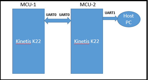

sunilkumar_sing
Hi Alice,
Thanks a lot, It is working fine for me as well.
I have customized the blhost utility to upgrade the firmware of K22F for Linux environment.
But In my project I am using two K22F MCU for different purpose.
Connection is like:
My use case is : MCU-2 firmware will be updated from Host and MCU-1 will be updated via MCU-2 over the UART.
I am confirming the feasibility and approche.
Please provide your inputs/suggestion.
Sunil
