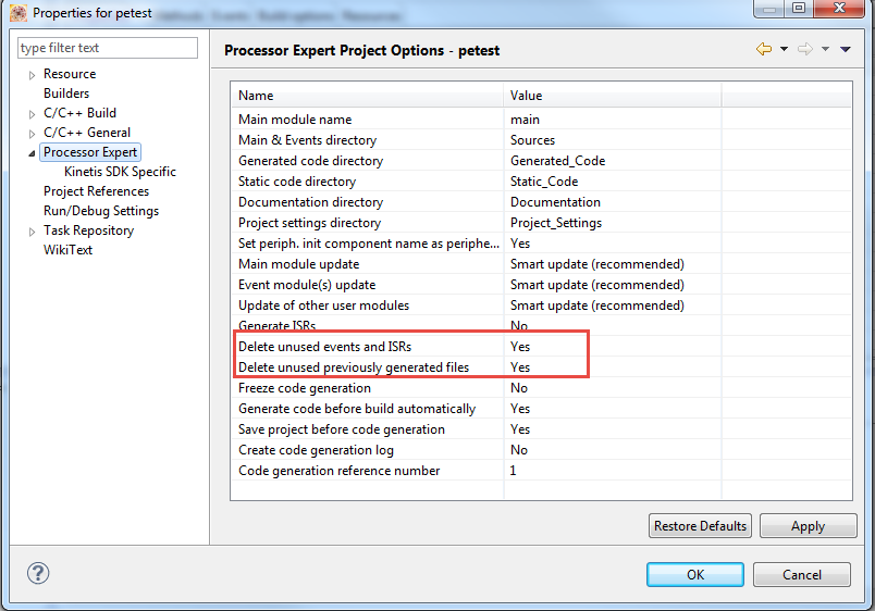

There is one issue regarding PEx and KDS which is quite annoying.
1. The PEx doesn't delete generated files from Beans removed from the project
2. The KDS project file compiles *.c
The net effect is that a PEx module which is removed, will be compiled with your project and may cause some
unwanted behaviour. Working one person may go right, if you are careful, but working in a multi-people project
will cause trouble.
I would like to have some kind of fix for this problem....

hi Ole,
can you please check if this properties setting can help you:
if can't help, please specify more about your problem, I will check it further. thanks!
