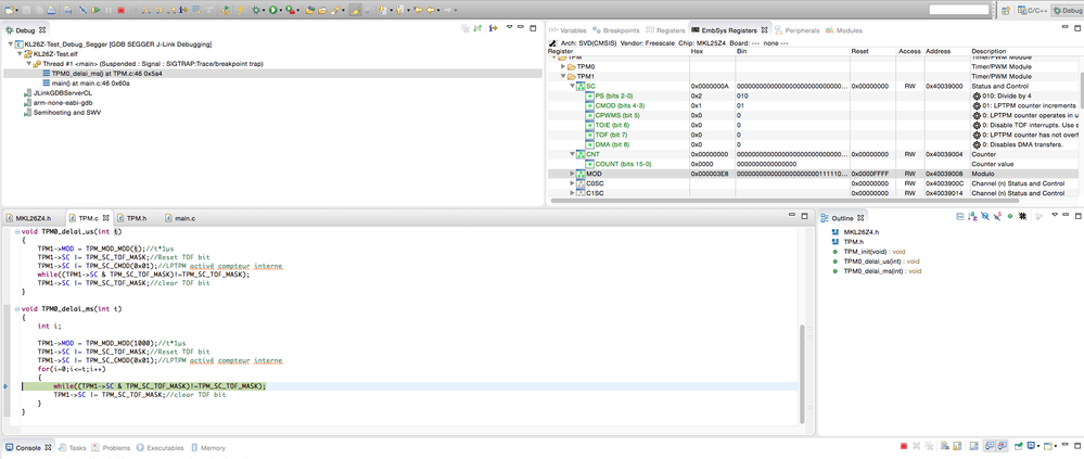

My project use a custom delay lib ( bare board lib, no PEx). It work very good on KDS 2 both Win7 and Ubuntu systems and I also used many time with Keil µVision. But when I used my delay lib on KDS 3 Mac version, it's not work. It seems that TOF bit from TPM statut & control register never set ( I check it with EmbSys Registers). I didn't notice any increments on CTN register too, maybe that why interrupt flag bit never set . So my code just stuck into an infinity loop at line 18 or 31.
Below the code of my delay lib using TPM0 and FRDM-KL25Z. I also tried with TPM1 and even another Freescale board (FRDM-KL26Z), no change
I should tested on KDS 3 Win7 version but I don't have enough time right now. I will do it later
What going on ? Compiler bug ?

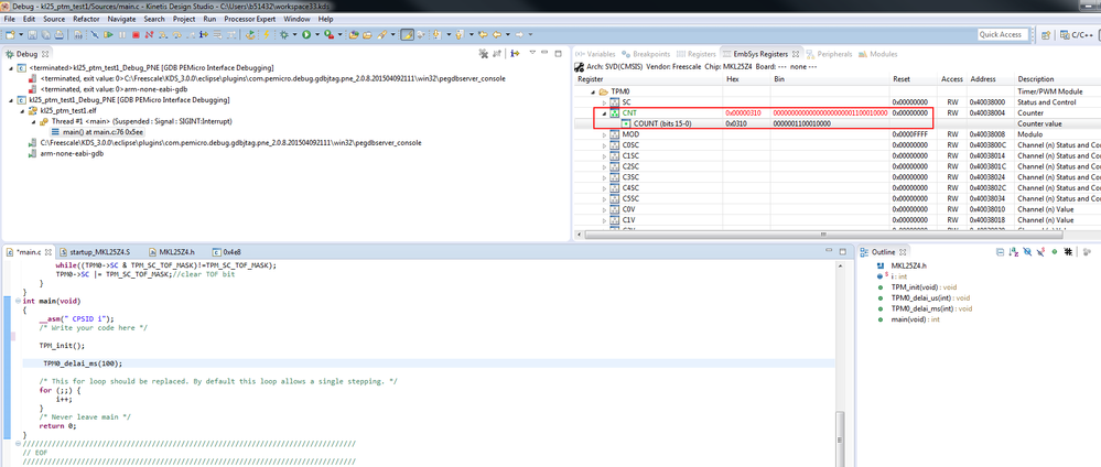

Hello Maxime ,
After i checked your code , i found there is a error :  SIM->SCGC6 |= SIM_SCGC6_TPM1_MASK;//TPM0 clock activé
this  enable the TPM1, while bellow you use the TPM0 , so please chang TPM1 to TPM0.
After changed it , I have test your code on win7 KDS 3.0 ,  it can work well . Please see the result :
Alice

Yes ,  i test on windows 7 KDS 3.0  about kl25 chip.
You said "I didn't notice any increments on CTN register too," , i have show the CNT register is increased above screenshot.
And when you check the register from "EmbSys Registers" , please double click the register or bit you want to checked, or it will not show the updated data .

mr_max
Yes I double click to active EmbSys Register (TPMx registers  appear in green) when I tested. Same problem with KL26Z board ...
